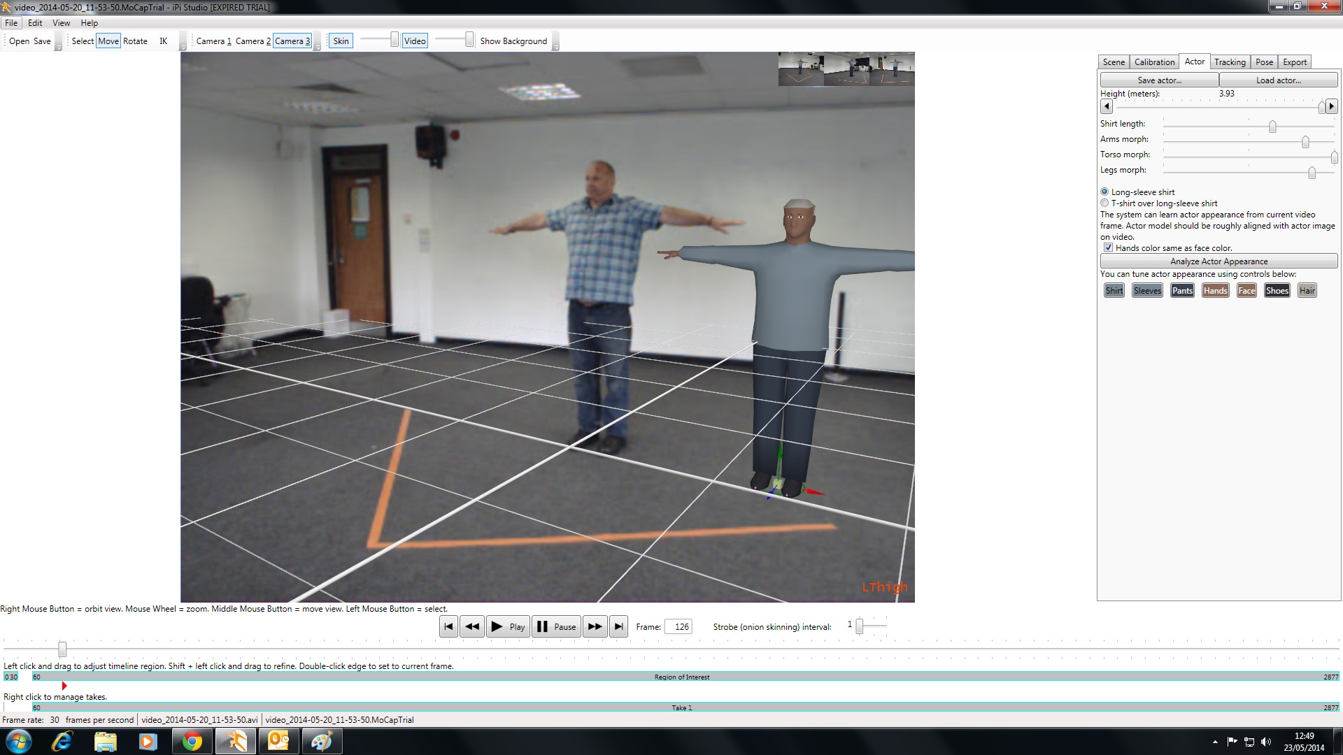

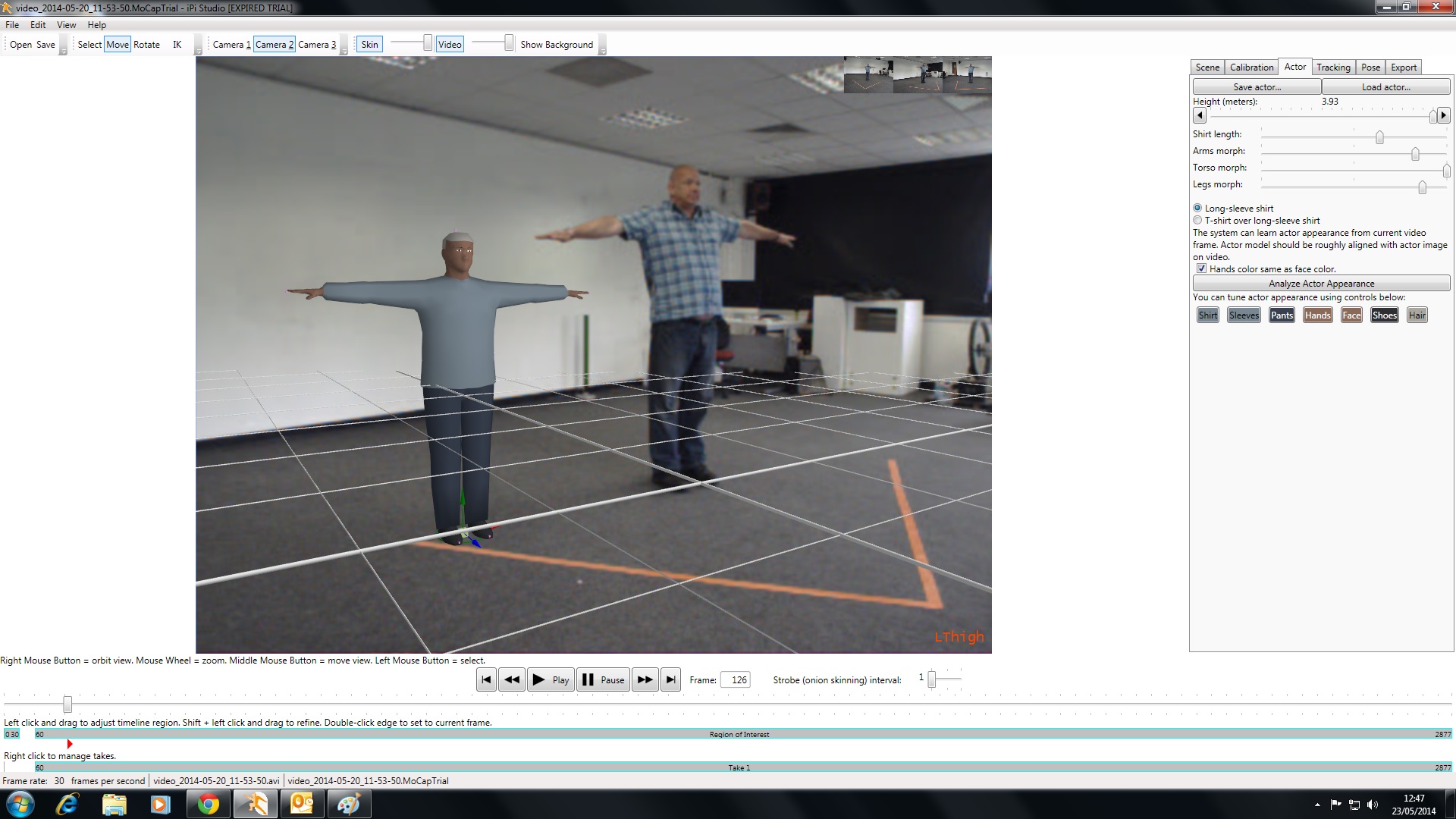

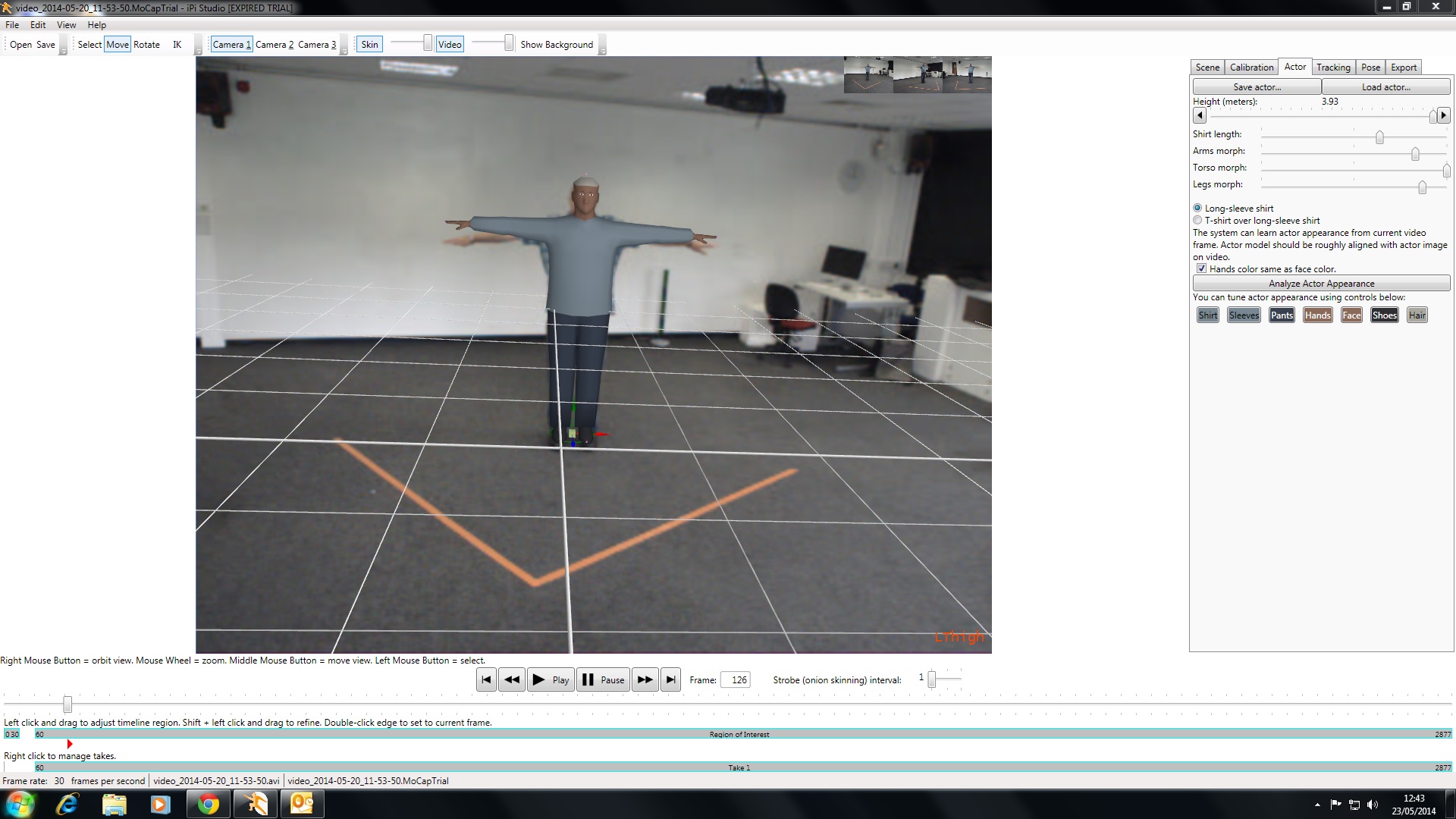

When trying to align my actor to the video it goes ok in one camera but then is miles off on the others. I have used 3 PS-Eyes for this. I have attached screenshots of these three cameras.

I suppose it's the result of bad calibration. Please follow carefully all steps and advices from our wiki:
http://wiki.ipisoft.com/Calibration
Also, I see that you're using an outdated version of iPi Mocap Studio (possibly, 1.x). Please download the latest release of our software from the website:
http://ipisoft.com/download
