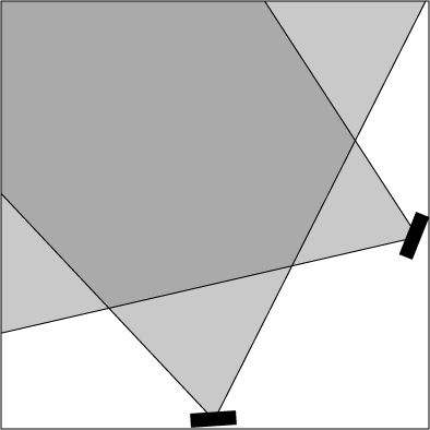

PostPosted: Sat Jun 02, 2012 8:19 pm
This is what I was picturing in my head, which is a variation of configuration number 2:
I'm not sure if this is any better than 2 but there you go. I thought this configuration might provide a deeper capture space but it looks like number 2 might give you a wider space.
Let us know how things work out for you.
PostPosted: Sun Jun 03, 2012 12:58 am
I adjusted the positions a bit and this seems even bigger plus you get full the 90 degrees. I'm not sure how well it translates into real world use but give it a try.
File comment: Configuration #3 Adjusted
