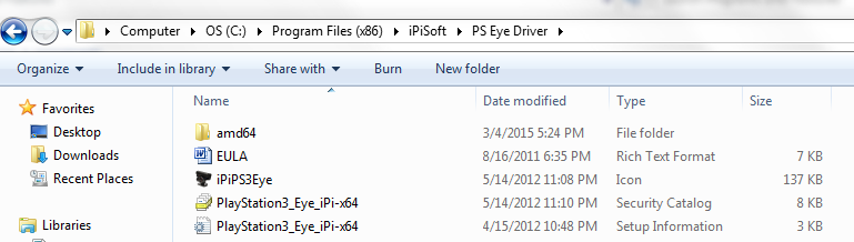

I both replied with the location and sent a screenshot of it as well. To repeat that here: c:\Program Files (x86)\ipiSoft\PS Eye Driver\Playstation3_Eye_iPi-x64
I have also:
completely uninstalled everything, rebooted, reinstalled everything
uninstalled the PS Eye Driver, rebooted, reinstalled the PS Eye Driver
Uninstalled everything, reboot, install the PS Eye Driver, confirm that it is recognized in device manager, reinstalled everything but the PS Eye Driver.
None of this has changed the behavior so far.
PostPosted: Sat Mar 07, 2015 1:30 pm
Thank you. We have not got your reply previously - maybe it was filtered out as spam occasionally.
One reason that Recorder can not detect the presence of PS Eye driver is some security problem: the program has no rights to see driver files. For example, it runs under very limited user account (such as Guest). Or there was some glitch during installation of drivers so that files have got unusual security settings.
Again, I recommend you to reinstall the drivers.
