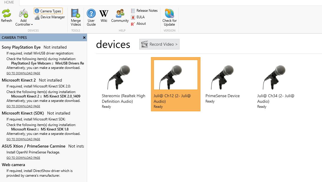

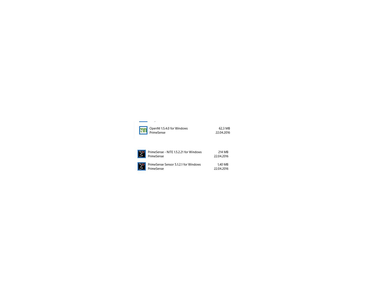

I just encountered a strange problem with my two ASUS Xtion PRO (live).
1. Initially the sensors worked fine in IPi Recorder 3 .
2. Due to some reasons I have reinstalled (on Windows 10) the 32 bit sensor drivers: OpenNI 1.5.4.0 ; PrimeSense Sensor 5.1.2.1 ; PrimeSense NITE 1.5.2.21.
3. In the Device Manager I can see the devices correctly as "PrimeSense PS 1080".
4. But IPi Recorder 3 says that the package is not installed and does not show the sensors.
Does anyone encountered the same problem ? Have tried again and again deinstalling , cleansing and reinstalling, so I would desperately appreciate any help.
Thanks in advance
Peter
File comment: Windows says OpenNI and sensor drivers installed
File comment: Ipi Recorder says Xtion not installed

I guess you've got 64-bit OS. Thus iPi Recorder runs as 64-bit application and cannot use 32-bit drivers.
Please install 64-bit OpenNI and drivers for Xtion.
http://files.ipisoft.com/3dparty/openni ... .0-dev.msi
http://files.ipisoft.com/3dparty/sensor ... redist.msi

PostPosted: Fri Apr 22, 2016 4:08 am
Have you used the links I've posted in the previous message to download the installers?
I have just checked these installers on my Win 10, and they install properly in the specified order - OpenNI first, Sensor second. And iPi Recorder 3 detects that drivers for Xtion are installed.
