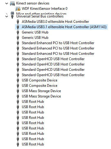

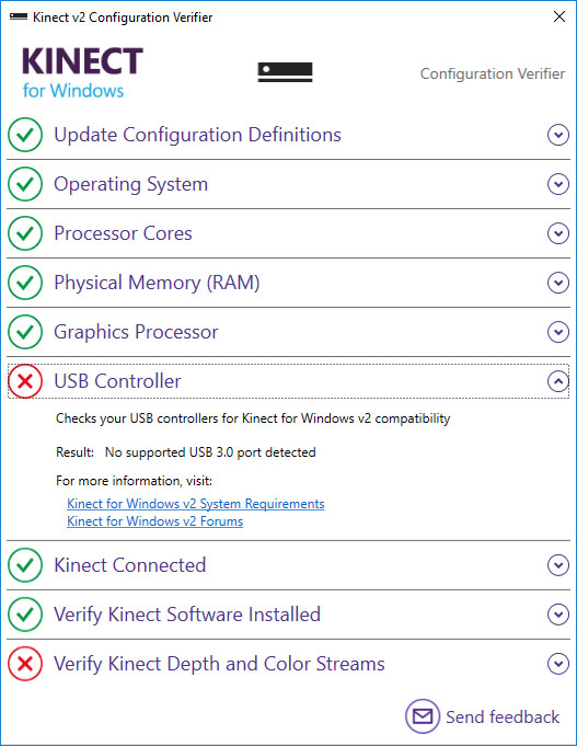

So, I have been trying to set up my kinect 2 camera on a new windows 10 computer I recently build, and upon running the kinect configuration verifier, it claims that there are no USB 3.0 ports installed.
My device manager disagrees, I should have 4 blue usb installed.
Am I missing something stupid? I have a conflic on the kinect camera, I assume because it;s not finding it correctly from the USB I plug it into. The camera works fine on my 6 yr old laptop, so it should work with a brand new build.
See attached screenshots

As you can see in system requirements, Microsoft recommends Intel or Renesas (NEC) USB 3.0 controllers. From the screenshot I see that your PC has got ASMedia USB 3.0 controller, which may be incompatible with Kinect v2.
Have you tried all available USB 3.0 ports to connect Kinect sensor?
Have you tried to disconnect all high-bandwidth USB devices before connecting Kinect sensor?
Also, check the Troubleshooting section for Kinect v2. Maybe you'll find something helpful there.

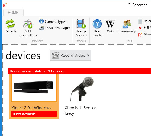

Thanks, since posting this, I have installed a seperate Microsoft usb card, and rolled back to windows 8.1
I actually managed to see the kinect working for 0 frames a second, but then it constantly looks like it is installing it over and over. I hear the sound for installing new hardware, then it updates the buffer picture.
I can at least now start ipirecorder with kinect camera, but it stays black screen.
