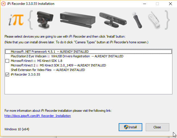

When I plug in my PS eye camera the system doesn't recognize it but the green light is on. Are there drivers I need to install for the system to recognize it?
PostPosted: Sat Aug 19, 2017 2:43 pm
The PS3 Eye drivers should have been installed when you installed Recorder.
Try running the Installer again. You should see the option to install necessary drivers. It should look like this:
If the drivers were not installed previously, make sure to enable them here.
If that's not the problem, try rebooting your computer. It's possible that the drivers were installed but not activated yet. Rebooting should activate them.
