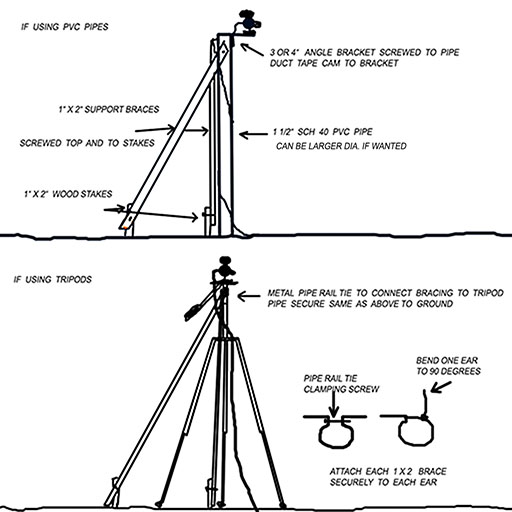

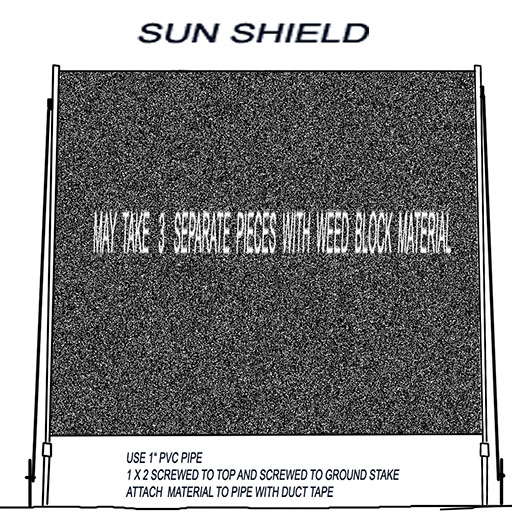

Here is a basic sketch of what you must do showing done with free standing PVC pipe or tripod to solidly secure them from any camera shaking.
Drive PVC pipe at least 12-18" or more into ground and use 2 screws on each end to connect brace to pipe and stake, may want to pre-drill smaller holes in pipe and wood braces, not through stakes, drive stakes in securely in ground first before attaching bracing to plumb setup.
Also basic sketch of the sun shield setup, lean pipes to an approx. 30 degree angle to shade capture area, and leave enough room to clear any cameras, top attachment pipes should be full 10 ft length and staked 2 ways like pipes below, use upright 1 x 2 brace stakes to support middle of pipes after leaned correctly, use additional pipes to extend width or make corners.
Be aware that sun moves, so setting up more screening is probably a good measure in advance, it disassembles very easily and just rolls up on the pipes when done.
A soft pine block can be whittled to fit tightly in top of pipe also to eliminate brackets.
This may seem like a lot, but it takes less than 30 mins. to get 6 cams and screen set up, before calibrating.
Remember, you need enough USB cables to extend to the cameras and not run through your capture volume, kicking around cables while performing ins't a good setup.
Hope this helps

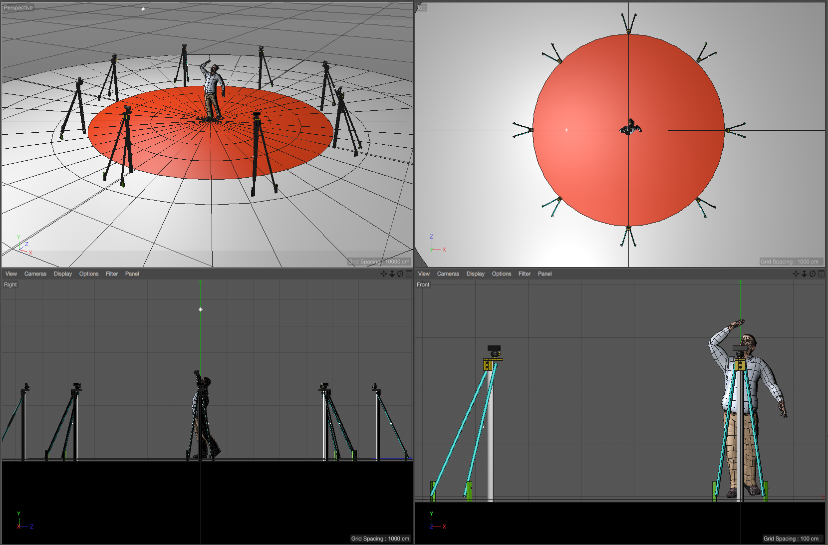

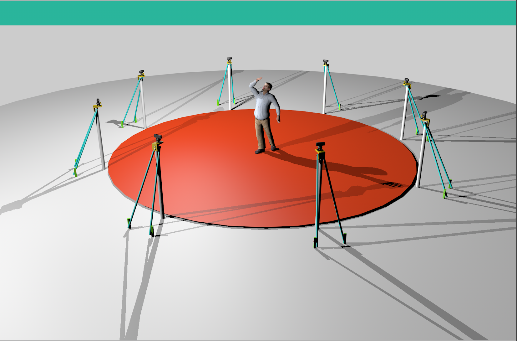

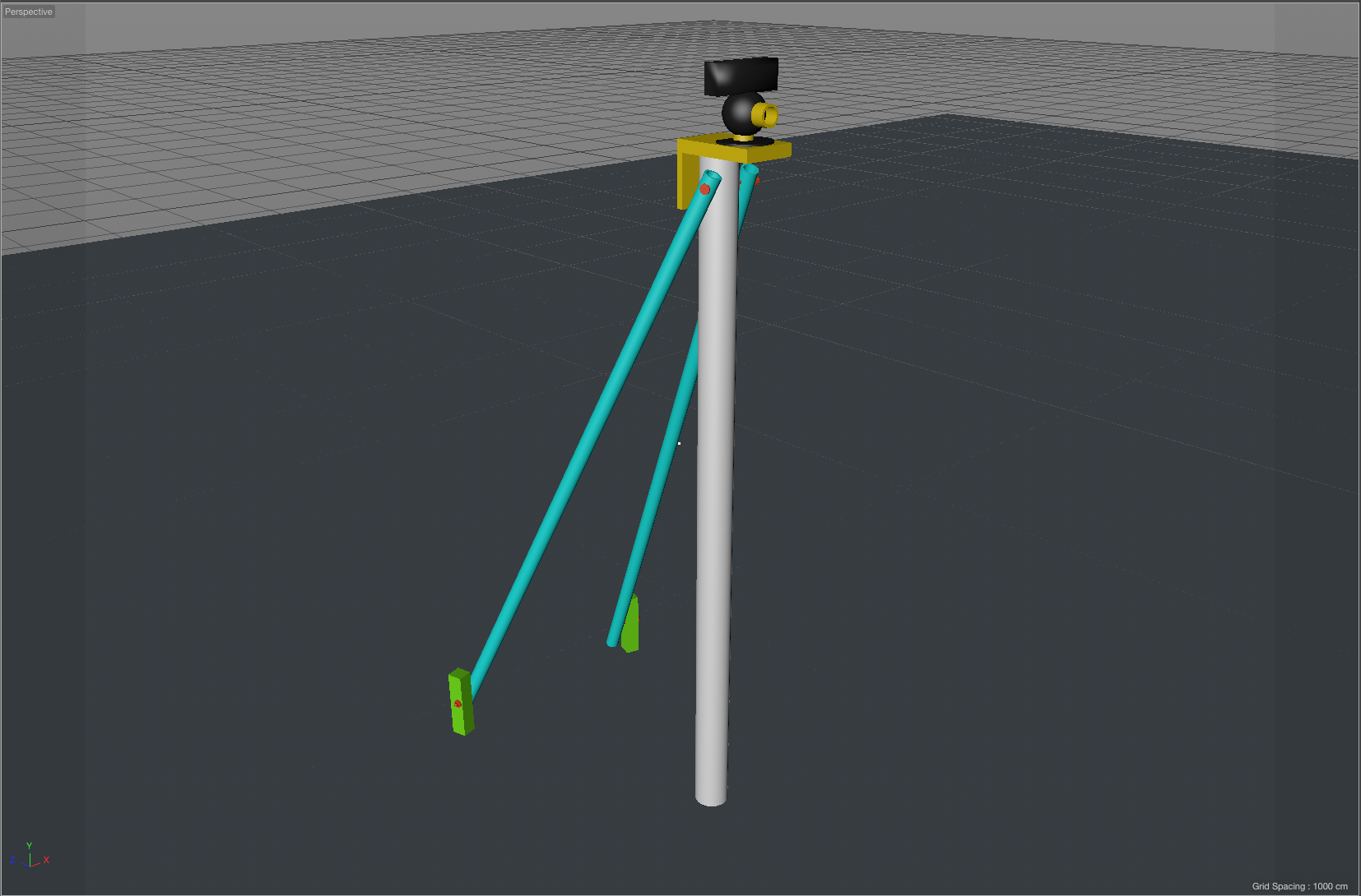

I made crude 3d of your schematic. Does it look like what's in the attachments here? I see this as a tripod with offset screwing in of the legs at an angle. also straight for the plank holding the ps3 camera. no way I can't assemble this too quickly, but for appearances, is this kind of what they should look like? a couple would be taller like you said for overhead.

Yes, looks like would work, maybe rear legs spread further apart to me, I used a 90 degree leg brace attaching method, but you may need 2 connecting screws on each end of legs most likely, or it will allow movement, unless you can use longer through bolt method and crank them down tight may work.
I am not sure PVC for the legs would be as good as 1 x 2 wood, just not as stiff, but you can try just one set up like you have it first, if that works out, good deal and no worry with leaving set up out in weather is another plus.
Larger dia. pipe will suppress movement too I am sure, but cost goes up also.
I have actually never used a directly pointing downward cam(s), I use them high and closer to center, but I know it works from the guy that made the rock climbing videos when I suggested it for him to try and it is used a lot on other camera based systems.
To get a stable setup 12 ft high which is basic minimum needed for direct overhead, may be a bit tricky, his was attached to the top of a solid climbing wall, so was stable, would just be something you would need to work on if wanted to try it.
That top plate is nice, but the less weight you have high the less wind will affect it, maybe just an end cap with flatter top, or filing a flat area if needed, if gonna use your design make it out of 1 x 4 PVC plank for weather resistance if leaving setup stay a long time, can make stakes out of that also, that stuff is stronger than wood even, but flimsier on linear length.
Give it a go with your drawing, I know you need the legs, positioning of them in ground is a basic what feels good thing, but you need the right to left chatter to be stopped, so whatever you do, that has to be achieved.
Shading that large of an area may be tough, but nothing is impossible if want to figure it out.
Good job, you got the right idea!
