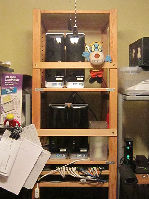

Technically it's a low profile card but it only came with a tall bracket. However, that's really only part of the problem: even though these USB 3 cards are short, the design is flawed because the aux power connector is on the 'top' side, which makes just a tad too tall for our computer cases. That's probably why the manufacturer didn't include the low profile bracket and the reason the cards were so cheap. Also, I misread the specs and thought they had SATA aux power connectors but it's Moly. I don't think I really need the aux power for the Kinect sensors but it's nice to have the extra juice for things like 'un-powered' portable drives. Fortunately, these cards are returnable so no biggie.
The replacement USB 3 cards I ordered should be the proper fit and type for our render farm cases. These computers are pretty small: we have four HP Slimline computers as our 'render-only' boxes. A few years ago we got a great deal on these computers plus the Slimline's small form factor and quiet/cool performance made it ideal for our tiny home studio--unlike the deafening 'jet engine' roar and heat of our old render boxes, which was hellish during the summer months. For rendering purposes. these tiny boxes are actually much faster than my workstation, and soon they'll serve double duty as our 'mocap farm'. The only downside with the Slimline boxes has been that you need to find very small parts for this model. (Thus the issue with the USB 3 cards we have now.)
Here's a pic of our farm. And, yes, our rack is a modified Ivar assembly from Ikea, complete with earthquake anchors. :)
Originally, we wanted to put six of these small computers on these sections of the rack--with our old computers, we could barely squeeze in four. (Our three larger workstations are on the bottom two shelves off camera.) But if we ever need to upgrade our farm again (hopefully not for a long time), we'll probably go with even fewer boxes with more core processors instead...that or start using a third party render service.
Anyway, assuming the new USB 3 cards do fit, we should be back on track for tests tomorrow or Monday evening.
