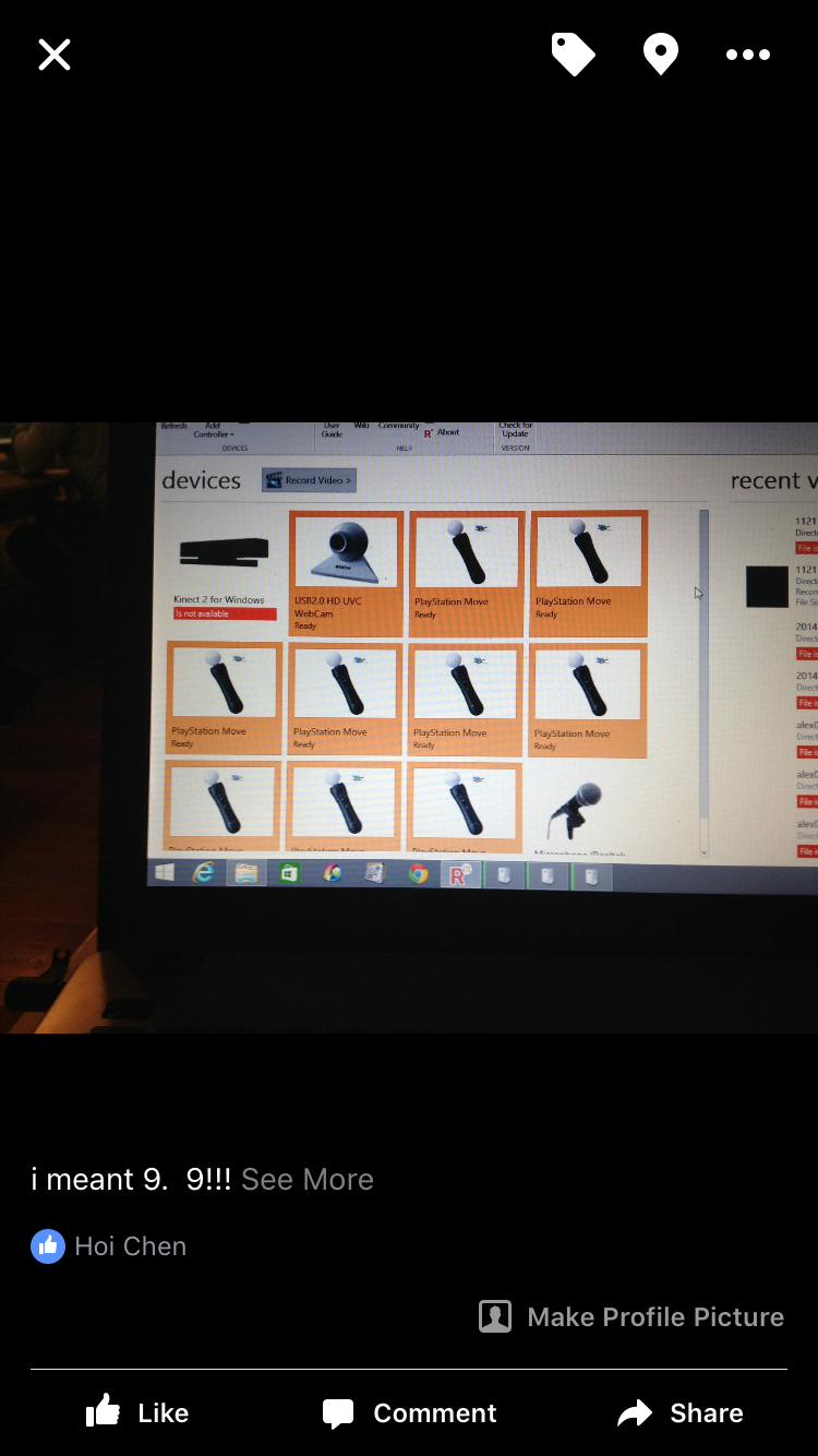

I don't know what changed between when all of my Move controllers paired in the past, but back then, I could pair as many as 7 Move controllers to a single BT dongle. Just in case BT traffic was too much, I used to pair my Move controllers on multiple BT dongles. If Mij is out and ipisoft recorder works similarly to Mij for the max #, which I'd say is 9; 3 actors; 3 heads and 6 wrists....
Pair 5x controllers to one BT dongle.
Pair 4x controllers to another BT dongle.
I never recorded 3 actors, but I did pair 9 controllers once in this way (see attached).
I sincerely hope that a similar work through works in present day ipisoft recorder. 7 Move controllers is the max for a PS3. No game on that console asks for more but no game I know tests for more than 7 Move controllers (barely know any that ask for more than 2 players). The double BT dongle, pair some with "BT-A" and some with "BT-B" dongle method has worked for me. I hope I does again:/

I am guessing that image is of your Win 8 laptop?
Well, I just tried using 2 dongles of the same model Asus and 1 asus and 1 IOGear and everytime I unplugged the dongle and replugged it, Win 10 tried to reload the native drivers, which was the same issue with MiJ, if you unplugged the adapter, I would have to use the DS3 Tool to repair them again on replugging, if left plugged into the same port, they stayed paired though.
Not trying to rain on your parade, just stating what I just tested, let us know if works for you though please.
If you can get 6 Moves to connect through 1 dongle, then all you really need for 3 actors using PS Eyes and up to 10 cams on one machine, I just don't have 6 to try it on Win 10, but if you wanted to use 3 more for the head, then 9 would have to connect through the same 1 dongle to not use distributed recording, or if don't you would need the MiJ work around.
