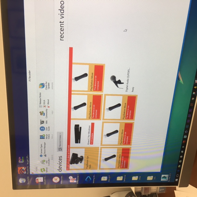

I only have 5x Move controllers with me today at the office. Tomorrow I'll bring in the other important 4 for a total of 9. 5 of these to a single problem works fine with my Trendnet 107UB. I purchased an Asus 400 BT to try with that one and the same good result. All pair fine. Now, what you can't do is pair with BOTH dongles separately as you said Snapz. I tried my plug-pair-remove theory but if you try to pair some Move controllers with one BT and a few with another BT you lose whatever pairing or driver works with the first pairing. So, while you can pair more than 4 Moves (see attached), I suspect you can go up to 7 total based on my experience trying in the past through MiJ. If I want 9; 3 Moves per actor, 3 actors, I don't think ipisoft recorder is gonna cut it unless you can distribute record on multiple PCs and pair Moves independently per PC. As far as I can tell, unless Better Ds3 can do this multi-dongle pairing method with ipisoft recorder or multiple pcs can pair controllers separately during distributed recording, im out of ideas:/
-snapz
just read your confidence in distributed recording. I hope that works. one PC just wont do them all. In the past through Mij, I never had to re-plug Move controllers to pair once pairing happened once. I did the BT-A and BT-B method in Mij days and this method used to work all through a single PC. Now....I hope you're right. still slowly acquiring W10 which is a must for pairing.
File comment: pairing in ipisoft recorder comes up good whether it's one BT or the other BT. Can't do both at same time with one PC

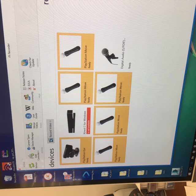

File comment: success

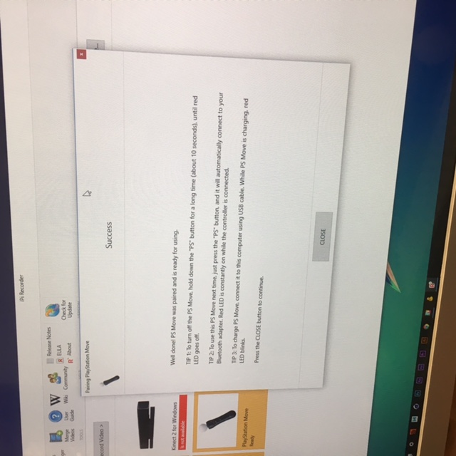

For weeks I've been struggling to find the reason I could not pair my Move controllers. Thought I found hope between OS 8.1 and 10 because I tried pairing on a desktop PC and that process happens flawlessly without any 3rd party applications like Motionjoy required. When I tried updating laptops. One an Asus and the other a MacBook Pro partitioned for windows, I was unable to pair motion controllers because there was something in the way that interpreted my Bluetooth stack to be overridden by...quite possibly....motionjoy drivers. Where they were located or hidden I don't know but this morning I wiped the slate clean on the Asus to the factory settings.
I started fresh, installed google chrome, downloaded ipisoft recorder, plugged in my Trendnet 107UB BT dongle, plugged in one Move controller, launched ipisoft recorder, added motion controller. Done.
Was tearing my hair out since I started this forum post. I never liked Mij. I only liked what it does but not how it did it. If anyone had problems like me after installing Toshiba or Mij drivers once but later they don't work, do what I did. Say "screw it, I'm starting over". A clean install solved all of my driver problems on one of my 2 laptops. The other laptop I may not need to go through this process, but I might if I want more than 6 motion controllers paired at the same time. 6 definitely should work from a single BT. See attached screenshot of success. Thank god! I was going nuts trying to figure out any way to pair without some wacky work around. I'm done with Mij. Gave me nothing but heartache
