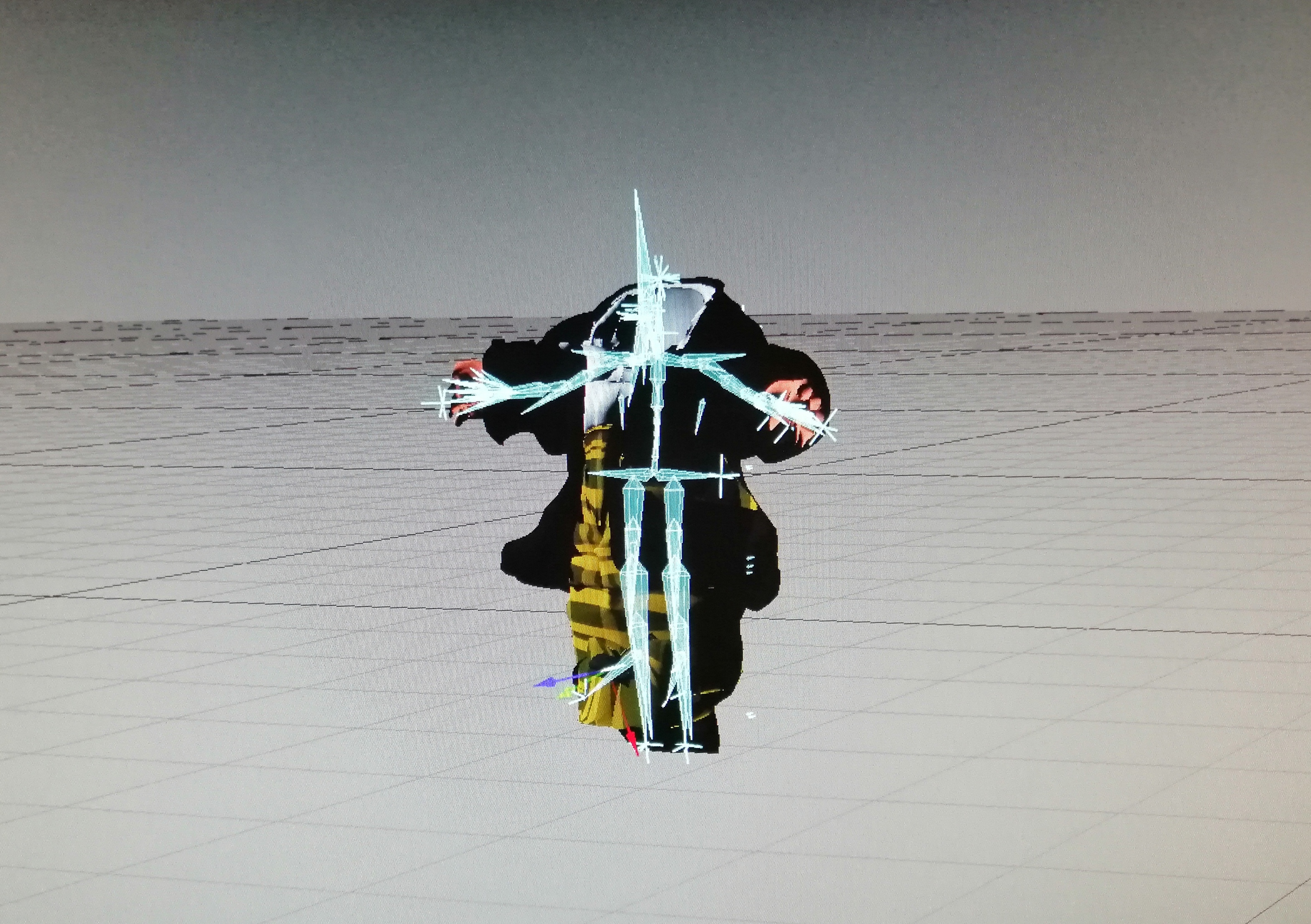

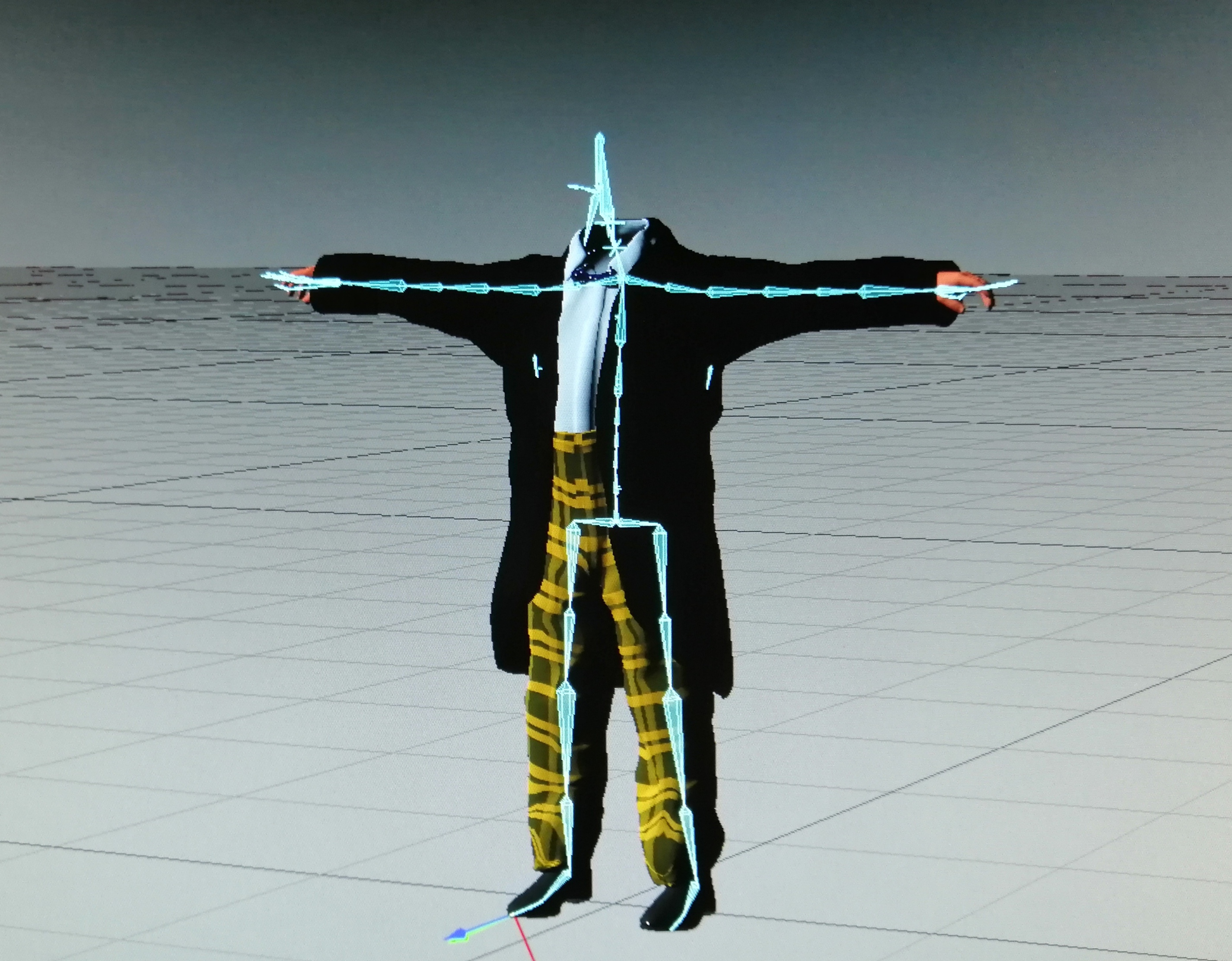

Yeh that's what I'm using. The biped Genoma mocap rig. It imports into ipi and out great and works in LW except for dropping a UV map. Maybe that's an fbx problem and not a ipi problem, I don't know. I have 5 uv maps in the original rig. As soon as I export to fbx I have only 4 with one uv missing which is a bit annoying. However it wouldn't matter so much if I could save the motion and put back on the original rig, but as I've mentioned it's just not working. I think something is going wrong with the sizing of the rig from LW to ipi and back again and that maybe what's screwing with the motion files. I tried resizing the rig but that didn't work either. Here's what happens. See images.
