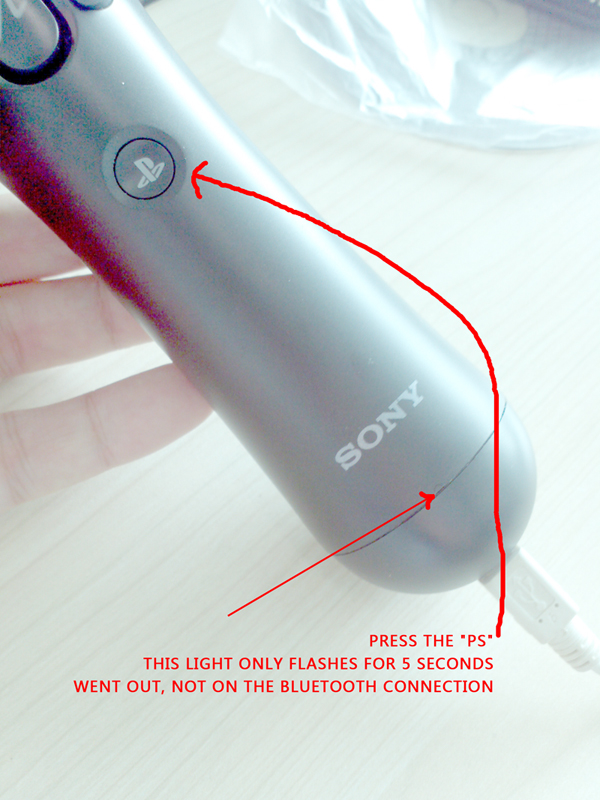

ps move how to connect?
I press the "PS", the red light went out a few flashes
Nothing happened

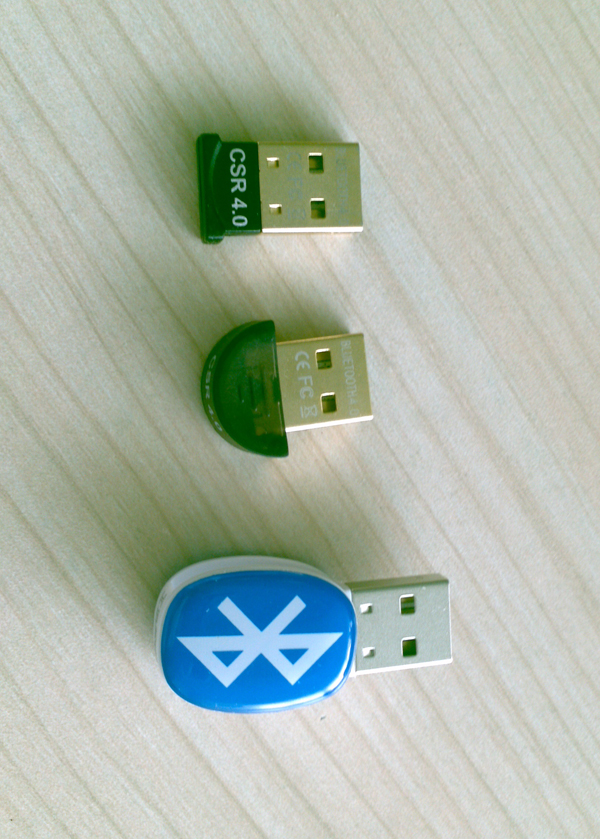

I tried three "MOVE" and 3 Bluetooth adapter
Not successful
What are the reasons?
I began to wonder whether you can connect PC

Bluetooth adapter is the problem?

baby3w,
I can only speak from my experience, but this worked for me (and my 4 PS Move controllers):
- purchased a Rocketfish Micro Bluetooth adapter (@ bestbuy, model RF-MRBTAD)
- connected adapter to USB on computer
- installed drivers from the Rocketfish included CD
- installed Motion in Joy drivers (v. 0.7.1001 from this page http://wiki.ipisoft.com/Motion_in_Joy_Installation
- followed instructions from link Greenlaw gave here: http://wiki.ipisoft.com/Getting_started_with_motion_controllers
(I should add that my system is Win7 64-bit, and a relatively clean SSD drive specifically dedicated for iPi Recorder,
so not a lot of extra software or drivers on the HD)
I kept each controller on after disconnecting the successfully recognized Move controller from the 1 USB cable I have
for the PS Move controllers. Repeated the steps for 4 times and all were recognized.
Hope it's of some assistance to you and you get your controllers working! :)

PostPosted: Wed Jun 19, 2013 4:01 am
Here is a live video of pairing procedure for PS Move in iPi Recorder on Windows 7:
http://vimeo.com/bassill/pairing-ps-move-in-recorder
Pay special attention to how many times I press the PS button during the procedure - it's not just once, but about 7 times.
