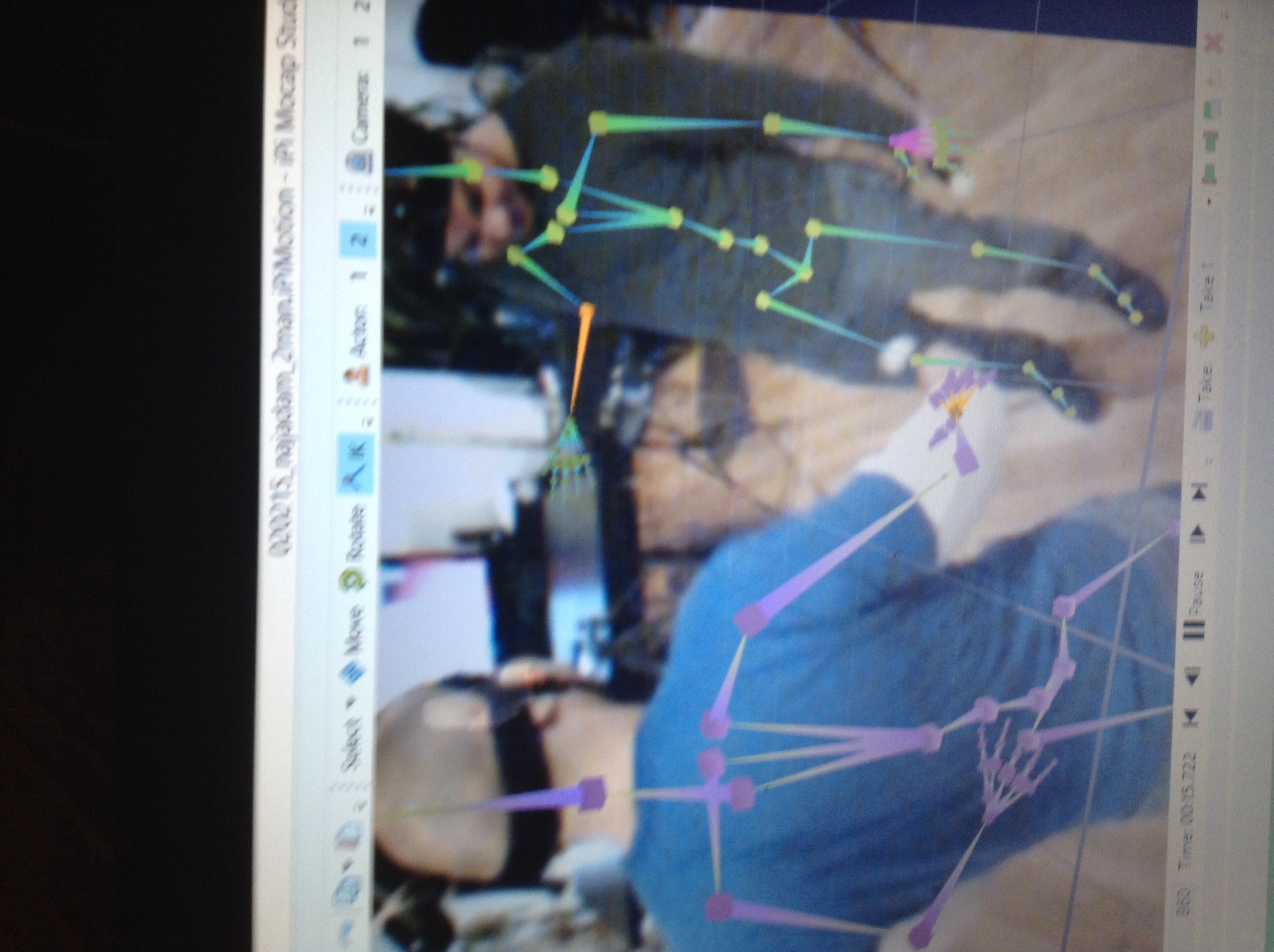

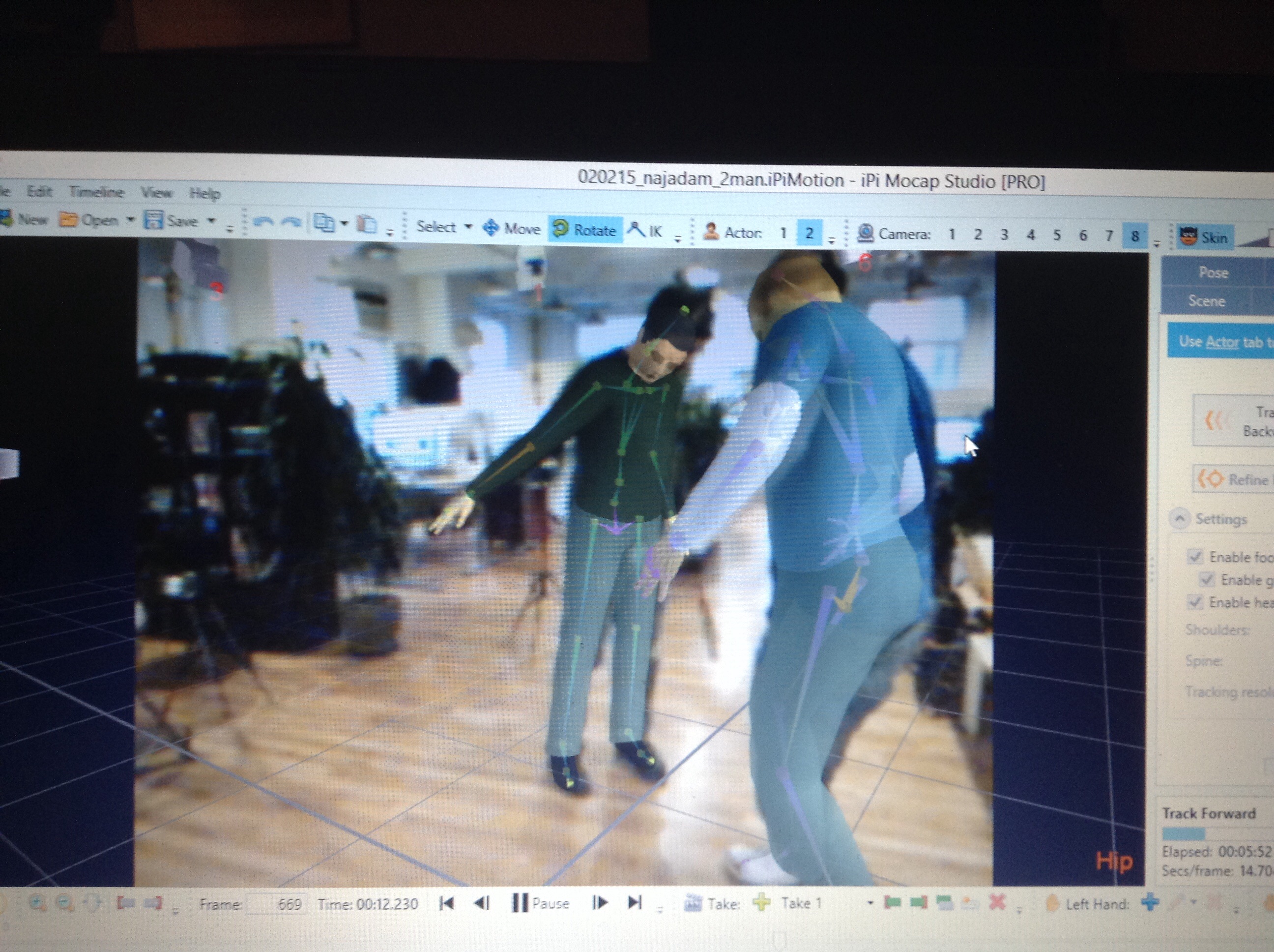

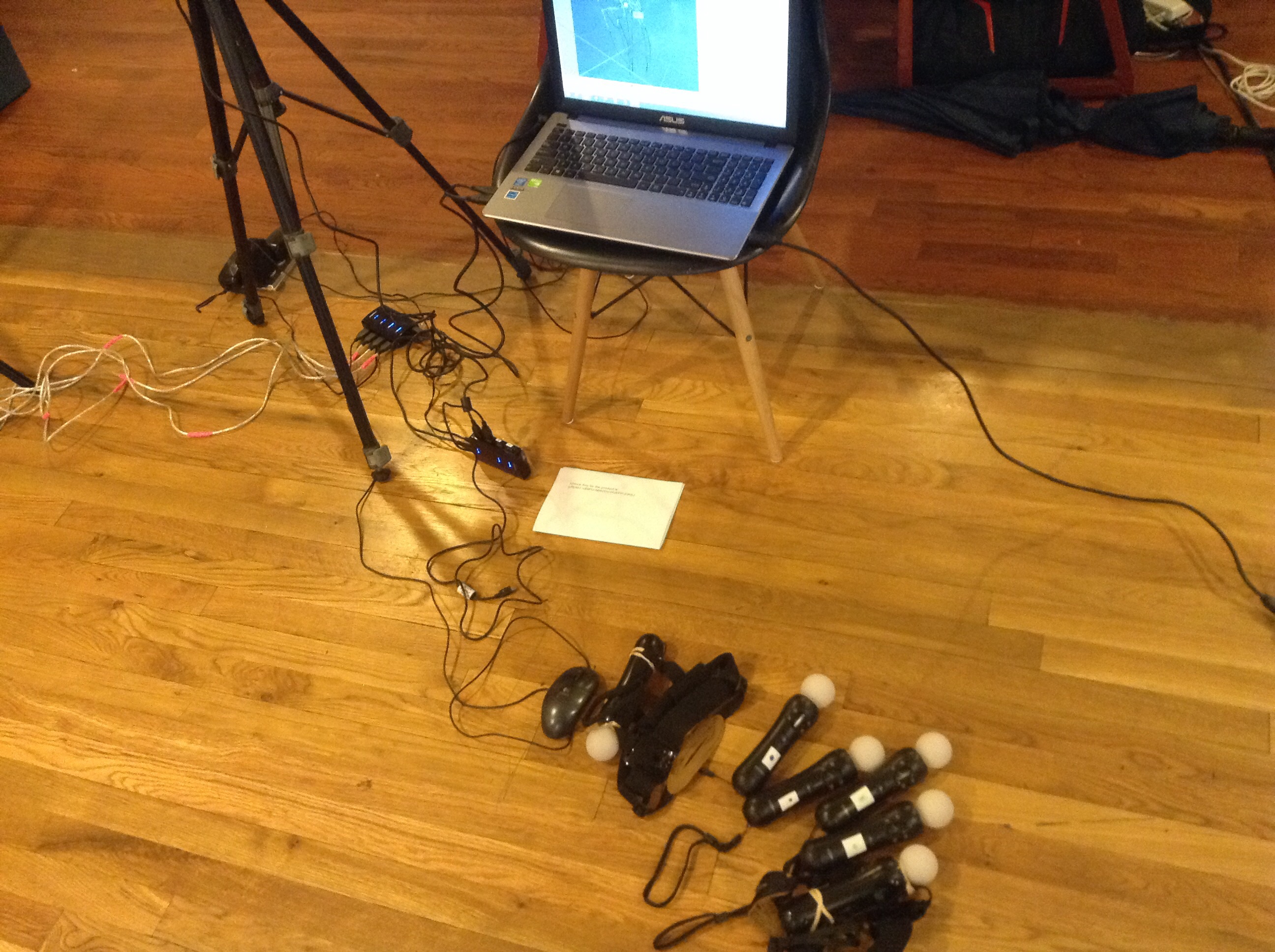

I'm not a PC user in general, so what dongles work with what kind of PC is, IMO, a cheap gamble that may require an exchange if the dongle doesn't work. I'm certain that there is a Wikipedia list of dongles that work with machines. Sorry the trendnet one doesn't work man:( I can assure you that it worked for me on an Asus laptop (not sure what model # unless I had it in front of me). I attached a couple of photos from a successful recording of 2 actors and 6 move controllers. Nothing technical and the computer was crashing a lot more than I hoped to get it to work. I have to dumb down the resolution of the ps cameras from 640x480 > 320x240 to get real time recording. It was hit or miss with 8 cameras. Might have to go down a few cameras next time. Anyway, don't spend a fortune on BT dongles. They're cheap and cheap ones should work. Please Wikipedia motionjoy to see what models work. Those are verified. I'm very sad this didn't work for you. Hardware to hardware is not my specialty. Had to experiment a bit to get things working and trendnet worked for me
