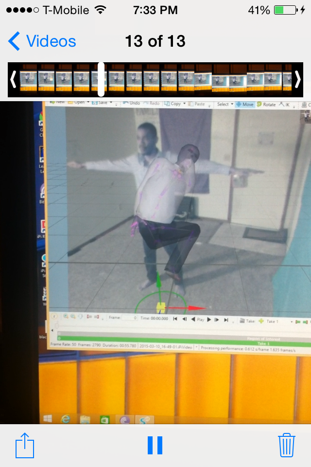

Hi, I'm using a 4-cam setup with an 8m by 6m space. I have already finished the calibration process for this setup. My issue is that when ever I try tracking or refitting a pose, the actor figure folds up or twists into a corner.Could anyone please explain what causes this and how I can fix it? I have a project I need to get done by the end of the week and this is holding me back. I also attached a picture of my cam setup (if that would help solving the problem). Thanks

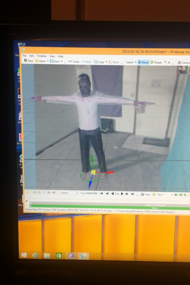

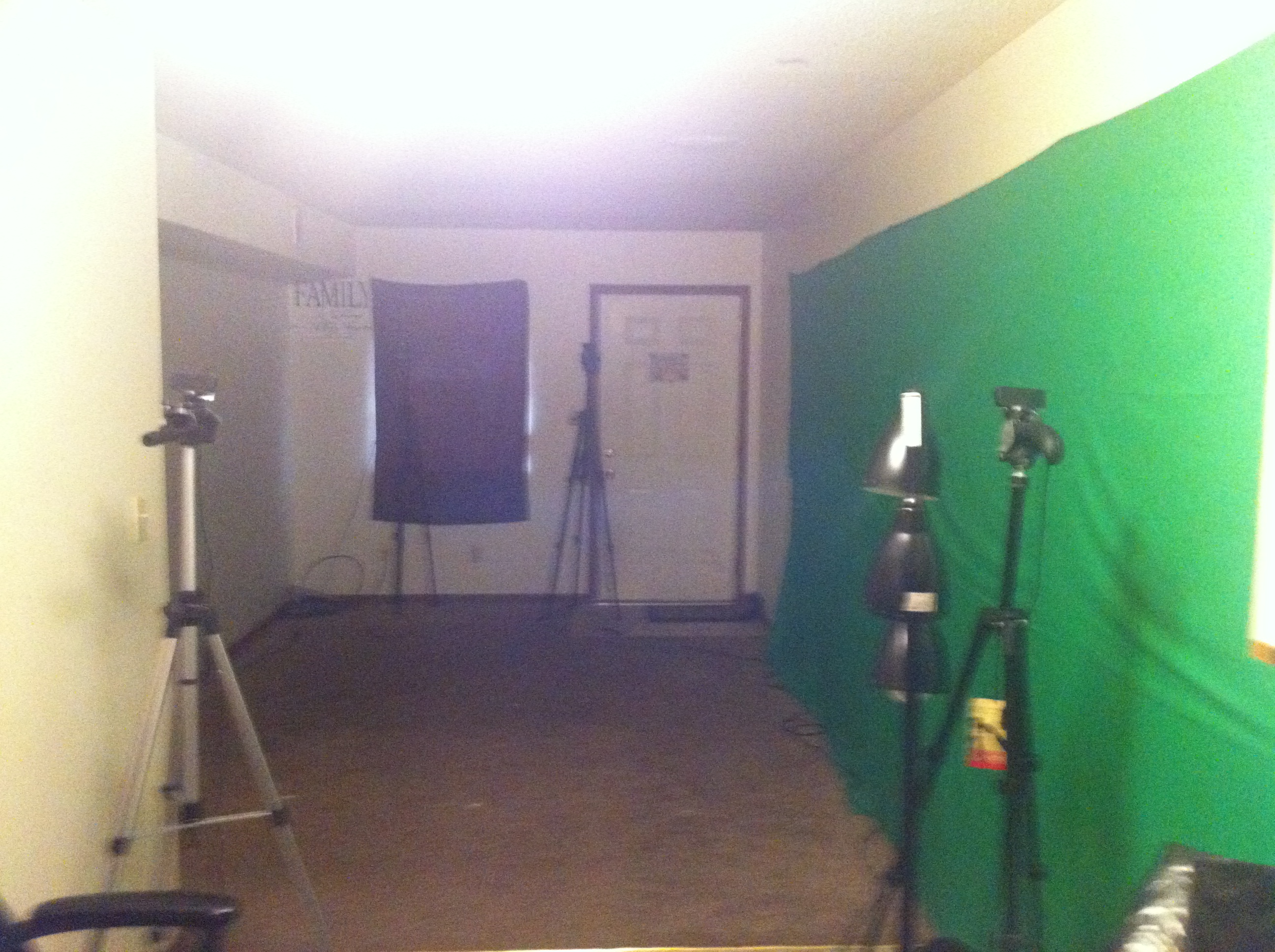

My calibration was perfect (all green). I think my cloth is okay, the light is good as well or do i need more light? I just don't know what i'm doing wrong. After I take a test record into the studio and try to line the actor with the video footage, following the tutorials by the word, analyze the actor and when I click refit actor, it just goes bonkers and twists into a pretzel figure. It is virtually impossible to get the actor to move to the same location as me in the video and align them. What do I do? Please help.

I also tried your suggestions but was still having difficulties. Whenever I click the refit pose button, the actor does not align to me in the scene. Also, my camera 2 and 3 shows a smaller actor. I don't know if that causes this issue. Camera 1 and 4 shows the actor in relation to my height though. Here is a video:
https://www.dropbox.com/s/32ygdzh7hesyn ... s.MOV?dl=0
In this video, I noticed the actor's arms where sort of in line with mine but the lower body was messing up whenever I click refit pose. I decided to where dark socks to add more contrast to my feet but that did not solve the issue.

The camera heights in .iPiCalib file (2.3 - 2.6m) are substantially greater than I see in the action video (about your height). You should adjust scene's scale accordingly. After I've set the scale so that camera #1 height is 1.75m, the actor's height of 1.77m has matched the video.
However, when aligning an actor with the video, I've discovered that I could not do that in camera #2. Its image looks slightly shifted. I suppose you might have moved this camera occasionally while going to PC and back between calibration and action shoots. Be careful about that.
The worst thing with your action video is lighting.
It is too dark - you see, the image of the cameras are very noisy. The only acceptable image quality is in camera #4.
The scene is lighted from one side only - due to that colors in the opposite cameras #1 and #3 are barely distinguished, especially in shaded areas. You should avoid directional lighting to get good tracking. Light sources on the ceiling are usually the best option. If you cannot avoid directional lighting, use lighting adjustments on the Scene tab to take it into account.
I've attached an action project with correct scale for cameras and adjusted light source position to give you an idea. However, tracking still does not work nicely due to the problems stated above.
Also I recommend you to change camera positions. Specifically, cameras #1 and #3 a very close to each other, having almost identical point of views. The same about #2 and #4. You should place the cameras to get as many different POVs as you can.

One issue is with the scene scale again. I don't know what the actual height of the cameras were, but the model height of 1.77m looks substantially lower than the actor on video. So I needed to increase it to 1.9m to make a match.
Usually height mismatch is caused by not very accurate scaling at the calibration stage. Unless you're doing some medical stuff where measures matter, you can safely adjust model's height to differ from the actual height of an actor. The main thing here is that the model aligns perfectly with the video. Then the tracking will go right.
