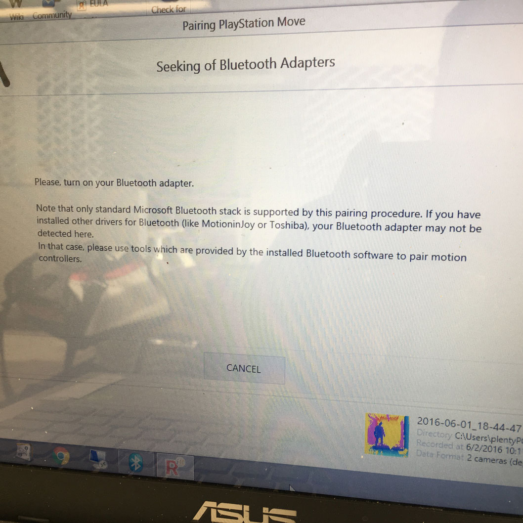

File comment: the message that comes up since I deleted motion joy. And motion joy doesn't work anymore.

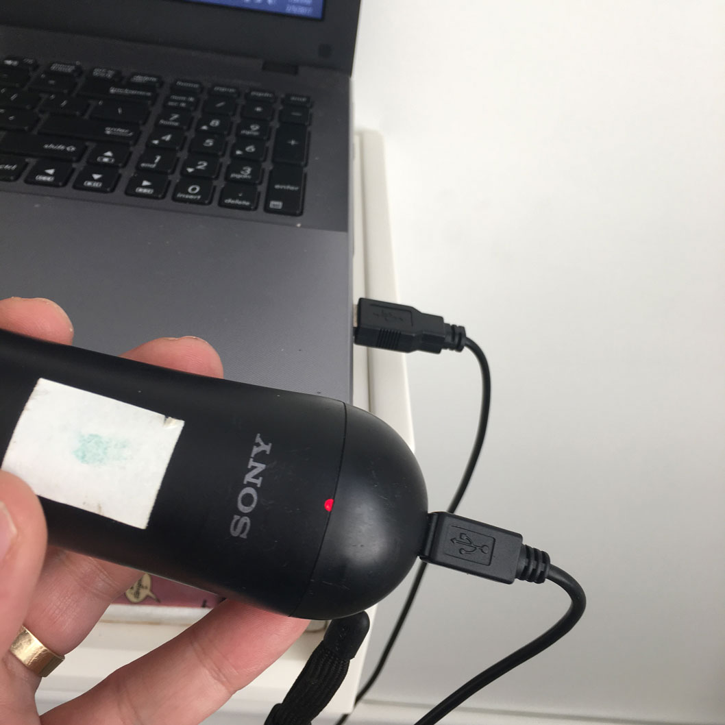

File comment: Move controller plugged into PC

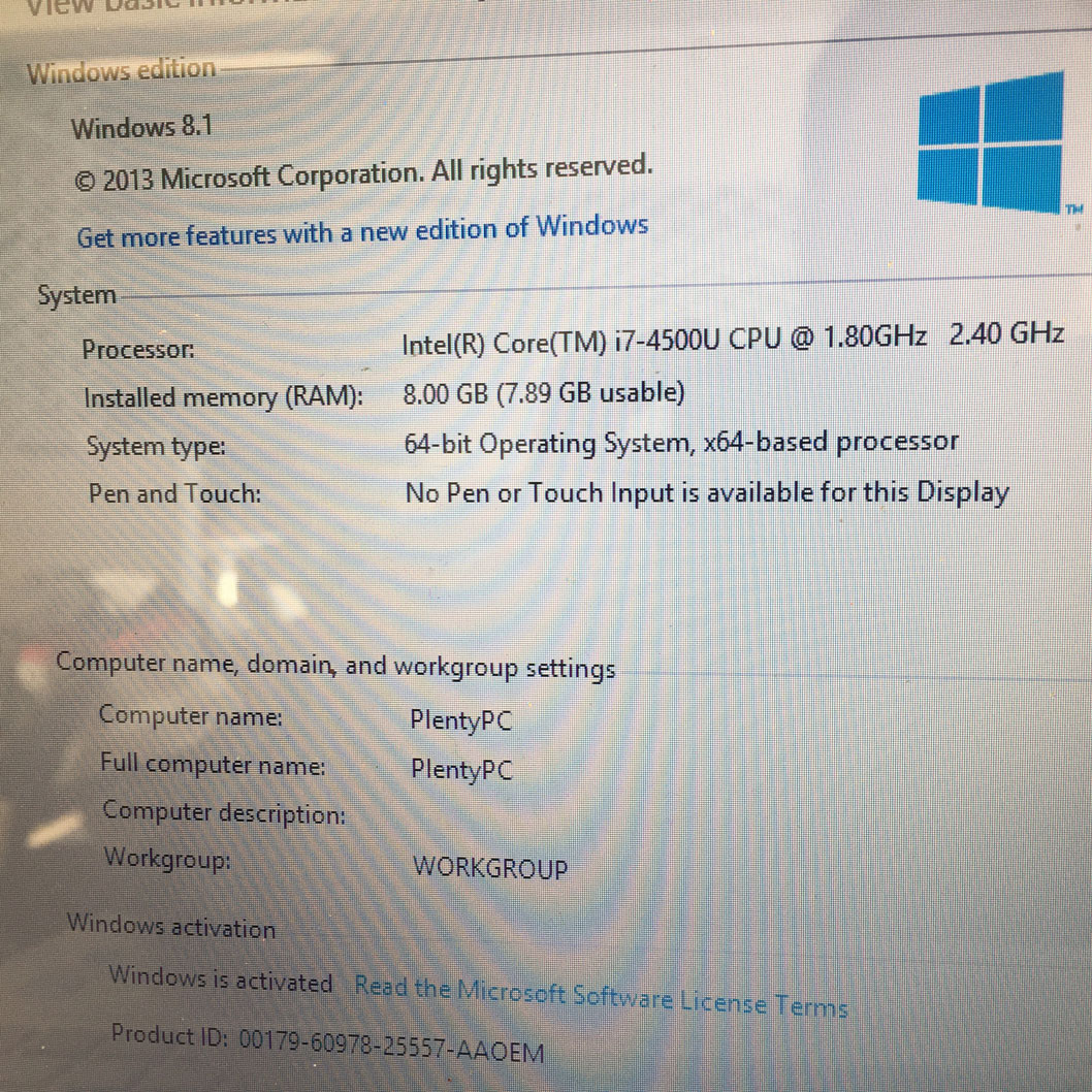

File comment: The operating system. Running Windows 8.

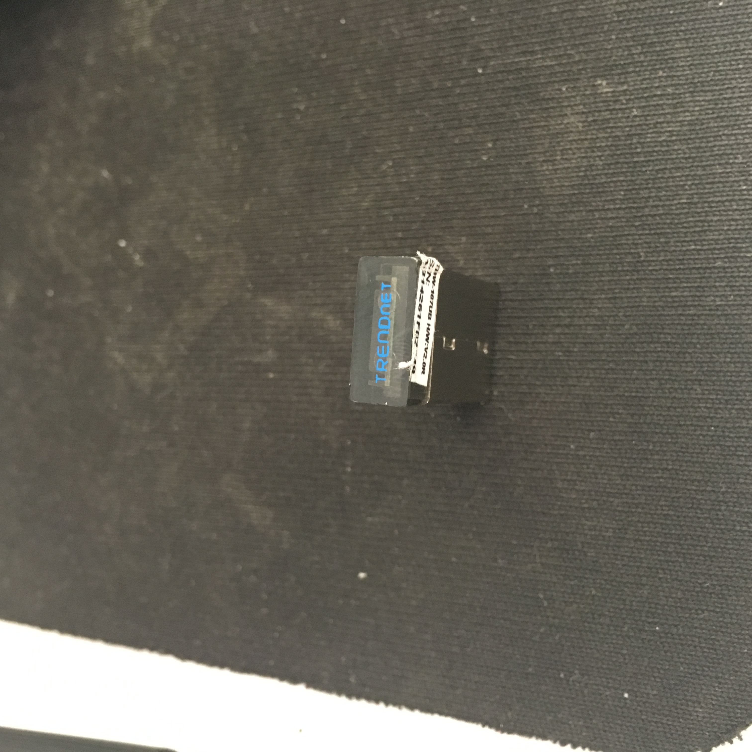

This is the dongle I am using. I think this is the latest version of it. Trendnet 107UB v2:OR. With motionjoy I was able to connect this way, but now, I can't even communicate with the dongle. I can't add the Move controller:(

As to your particular case. According to your 1st screenshot, Windows doesn't see your BT-adapter. Most likely, it concerns drivers issue. Either drivers for this BT-adapters are not installed, or drivers from Motion-in-Joy still present. Please, open Device Manager and check your hardware configuration.

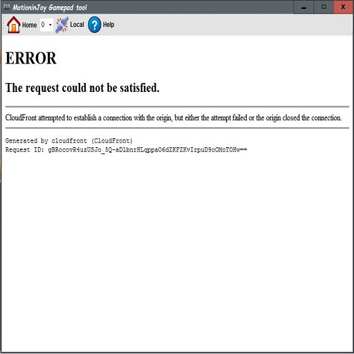

Yes, the Motion in Joy connection is broken now, there is no access and I never uninstalled it from my machine to switch to using the native drivers for Win 10, I just tried to run the DS3 Tool and it says connection error now.
