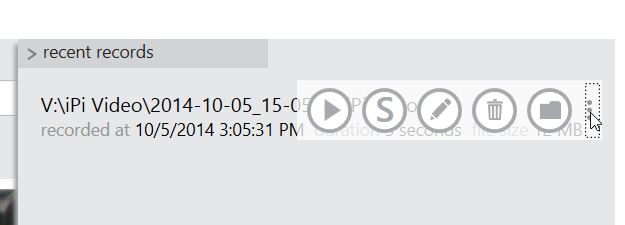

You already have this option. After you finish a shot, the side panel with recent records opens automatically. Move mouse over the most recent record (the topmost in the list), and you'll see a toolbar with Play button. But there are also 3 dots in the toolbar which expand it with more buttons: Open in Mocap Studio, Rename, Delete and Open Containing Folder. All these actions are also available when you open a record in player.
File comment: Actions for recent records

Ah, thanks for pointing that out vmaslov, I didn't see that button. Wakey wakey!
