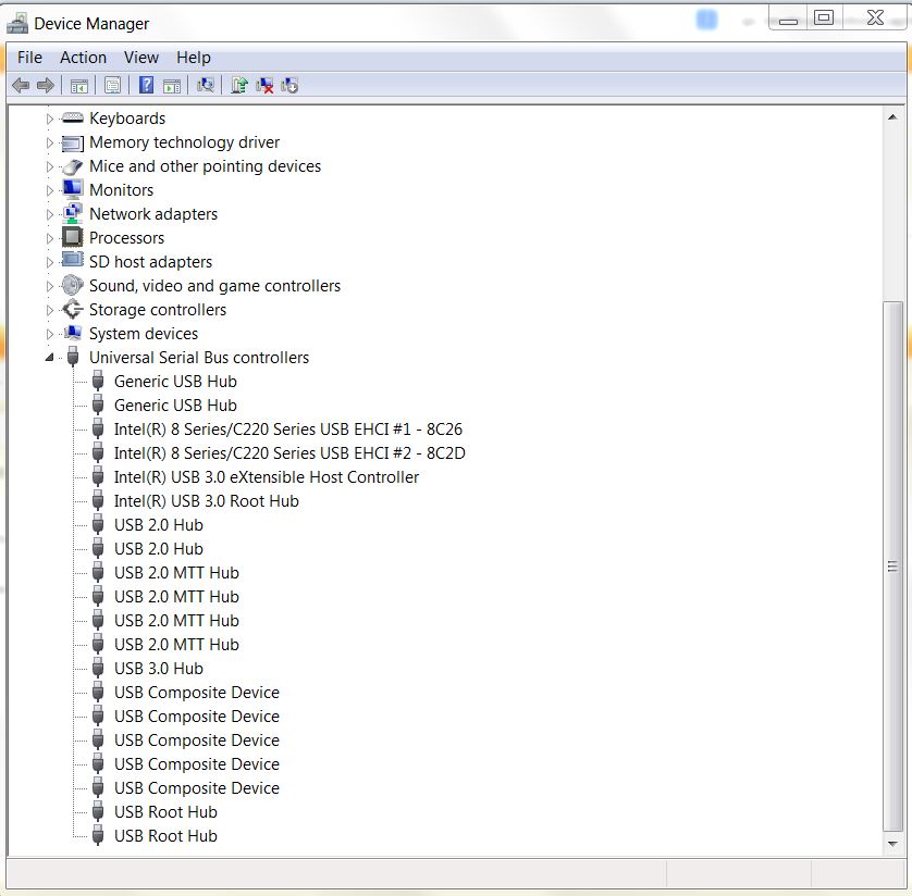

there are 4 usb plugs on the case two either side but i've never understood what the device manager info means
see attached

Regarding connections. It looks like you have 2 USB 2.0 controllers and 1 USB 3.0 controller. However, the Device Manager cannot show the number of USB ports and how they are connected to USB controllers. If the laptop has both USB 2.0 (usually black/white ones) and 3.0 (usually blue ones) ports, then at least 2 controllers are available. Use USB 2.0 port(s) to connect 2 cameras, and USB 3.0 port(s) to connect another 2 cameras. If the laptop has only one port for 2.0 or 3.0, then use USB hub to extend the number of the ports.

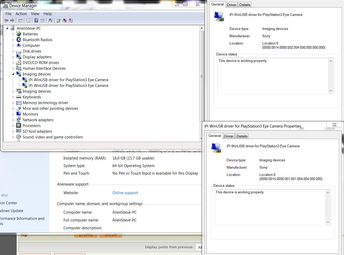

Do you have any problems with cameras indicated in Device Manager (exclamation icon on the device)?
PS Eye devices are located under the "Imaging devices" tree node.
PostPosted: Tue Mar 25, 2014 4:03 am
Joined: Tue Apr 21, 2009 3:15 am
Posts: 21
no there is no alert on them
see attached
