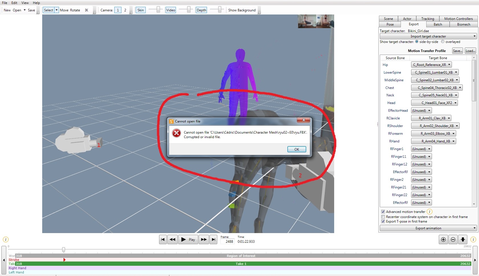

First, I can't import of 3D model in format fbx. When I importe a model in fbx format, this message appears (see screen below).

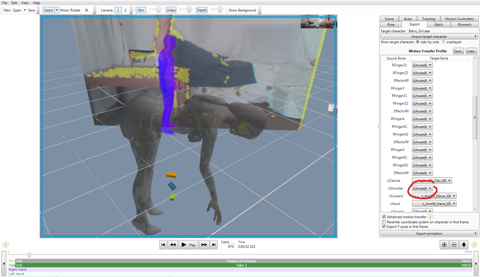

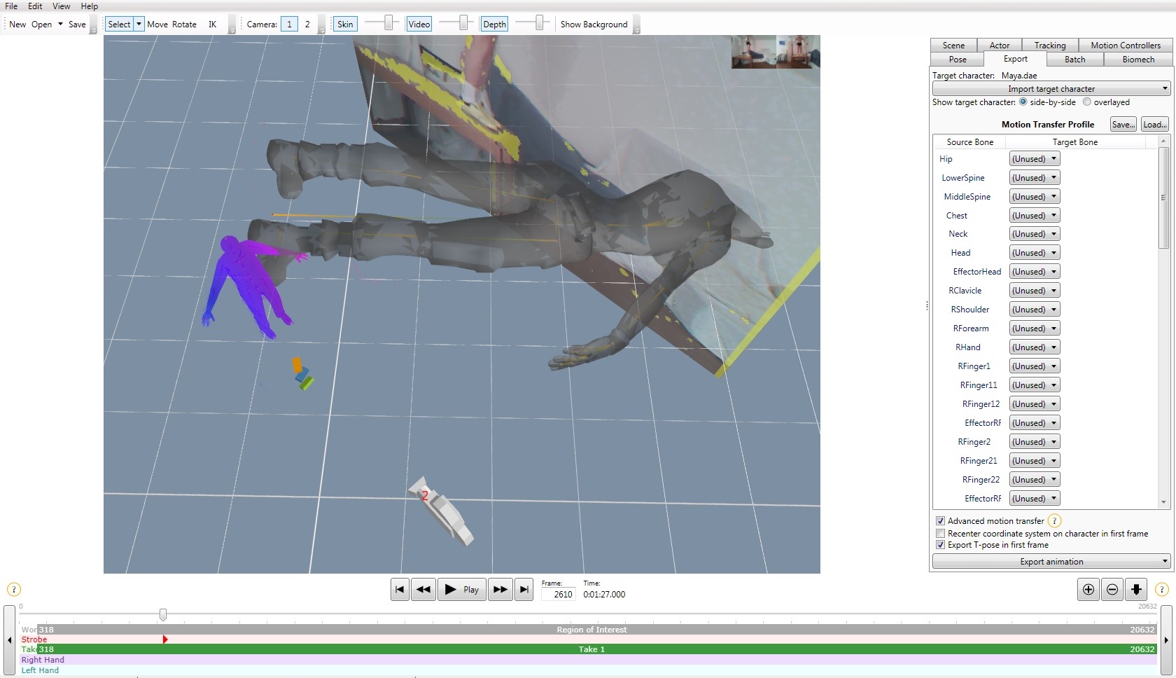

Then, when I importe a new 3D character in dae format, the character appears in T pose but perpendicularly to my actor and much bigger.

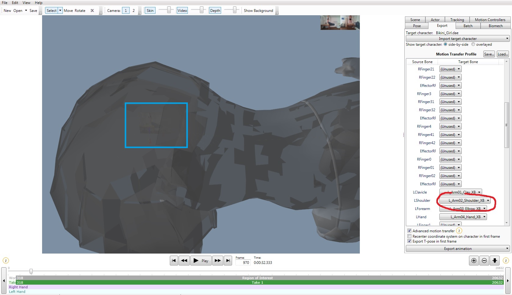

Once I have linked the Source Bones to the corresponding Target Bones, the 3D model's legs and arms seems to be ok but the torso and the head are always against the ground (see screen below).
And sometimes when I link some bones, the model becomes really gigantic compared with my actor (see screen below).

What software (and version) you're using to get your model in FBX format? Maybe, it uses some newer features of FBX format that are not supported by the current version of iPi Mocap Studio. If there're some options for compatibility with older FBX, try using them when exporting model for Mocap Studio.
Regarding orientation of the model it seems there is inconsistency in coordinate systems. Our software expects Y axis is oriented vertically, from the feet to the head of the model.

I've seen when I've read you answer I posted the second screenshot twice. I send you so the one which shows how the model begun gigantic after I've linked a Source Bone to a Target Bone...

First (Ryu, FBX) has been imported without an issue. Possibly, your file was actually corrupted. However, it appears to be not rigged. There's only one bone - root. Thus it is not suitable for applying skeletal animation.
Second and third (DAE) are not oriented properly in Mocap Studio, as on your screenshots. As I've previously suggested, these models were authored so that the spine is oriented along Z axis. Mocap Studio cannot handle models with such orientation. Either you should edit these models to change the orientation so the spine goes along Y axis, or find other models which orientation suits Mocap Studio.
