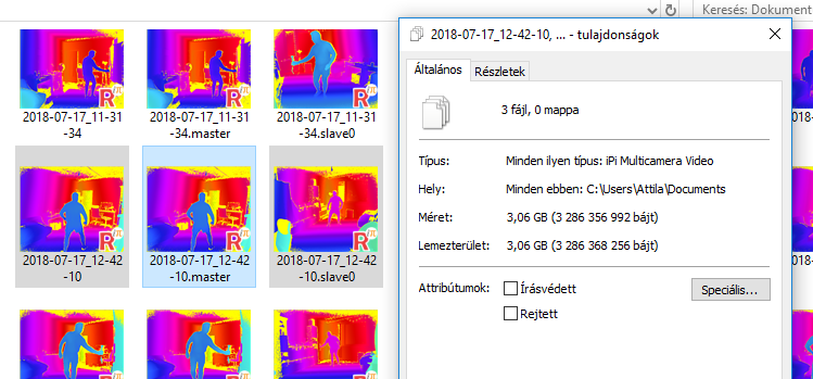

Okay I don't have any problem with it. Can you give me an ftp or something like that in private pm where i can upload my files? They are massiv 3,06GB or the combined video is enough? (1,52GB)

You can use any file sharing service out there. This one is convenient for one-off transfers (with limit of 6GB)
https://filetransfer.io
