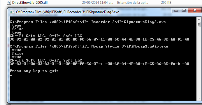

Here you go Andrew,

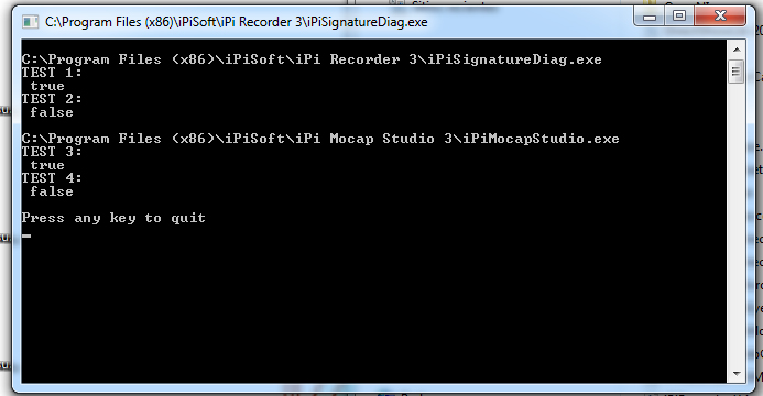

PostPosted: Wed Nov 05, 2014 3:01 pm
Joined: Wed Sep 10, 2014 10:19 am
Posts: 5
Here you go
PostPosted: Wed Nov 05, 2014 3:46 pm
Posts: 466
denisarana,
Thank you again and again!
Due to your efforts, the issue is localized. We don't understand the roots of such behaviour on your system, but in spite of it we can develop workaround. Can you pleas also run the following application (and post results, as usual):
http://files.ipisoft.com/beta/v12U9DHM4 ... eDiag2.exe
Many thanks!

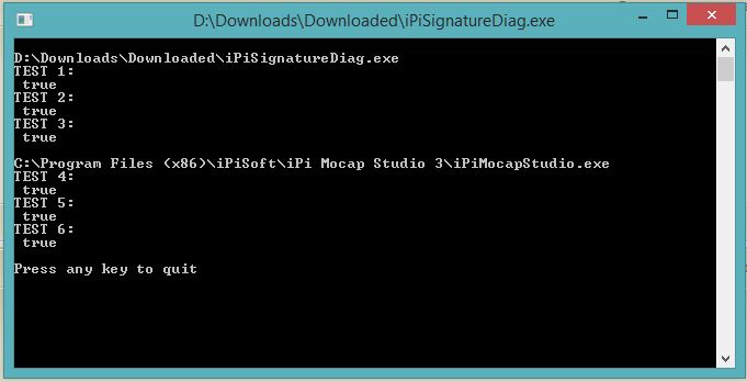

PostPosted: Wed Nov 05, 2014 4:34 pm
Joined: Tue Nov 04, 2014 1:08 pm
Posts: 10
No problem, Hope this helps ;)
PostPosted: Wed Nov 05, 2014 10:24 pm
Posts: 466
denisarana, thank you!
We'll update iPi Mocap Studio in a day or two.
