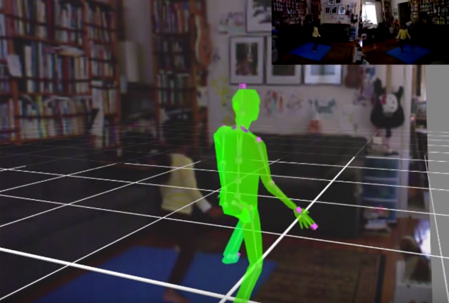

You could display RGB as a PIP or as a backdrop as far back at DMC 1.0. Here's an old video that shows this: https://www.youtube.com/watch?v=PJZabVZqCl0
I'm not sure if I was using Kinect 360 or Kinect for Windows (1.0) back then. I'm guessing this was 360 since it was captured using one of the earliest releases of iPi DMC with Kinect support. Yes, now that I recall we made Happy Box using iPi DMC 1.0 and dual Kinect 360 sensors. I don't think we upgraded to using Kinect for Windows (1.0) until we started working on the music video and using Mocap Studio 2.0.
One other useful feature for RGB capture was being able to see what the live hands were actually doing during capture--the video as seen from multiple angles was excellent reference for posing the cg hands. Of course, once I started using Move Controllers, the visual hand reference wasn't no longer useful.
I think it was version 2.0 that introduced projecting the RGB video onto the geometry. I'm not sure this has been very useful but it sure looks neat. I guess it does help a little for identifying orientation of the head and torso.
