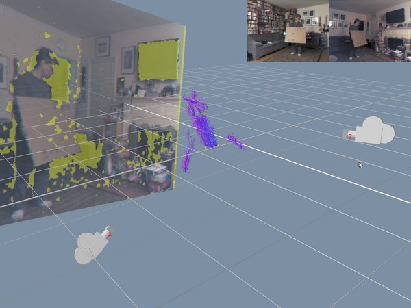

Here's the original 180 footage re-calibrated after manually rotating camera #2 around 180 degrees.
The camera and figure now appears to be correctly positioned. However, the 'hidden' background now looks very messy. Rotating the camera has apparently thrown off background subtraction.
Maybe this is not important for tracking--I'll know in a bit.

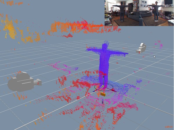

Auto Detection for 90/180 doesn't seem to work very well for 90 degree capture either. In the example below, the devices are set apart to less than 90 degrees--this was the configuration I used during the Happy Box production.
As you can see here, this time the system assumes I'm using the 180 degree configuration. Perhaps it's best to give this decision back to the user, or at least make it optional?

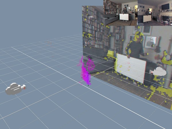

It seems to have become quite difficult to get a good calibration with the latest build. The following is the less than 90 setup I typically use. This configuration has never given me trouble before but 147 seems to fail at calibrating this basic setup almost every time.
So far, 147 has been very problematic for me. I'm going to try re-installing the software and see if that helps.
