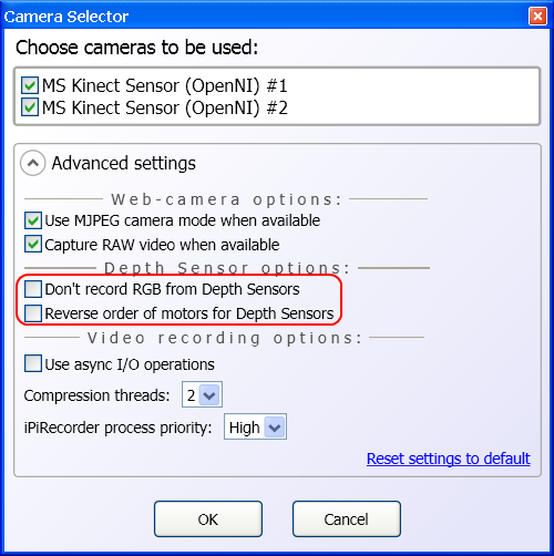

Hello.
This is my first time using Motion Capturing software. i was able to install both IPI recorder and Motion Capture Correctly and was able to use it correctly to track a person and Export the data to be used into 3ds max. the problem started when i reopened the Recorder. the video seem to spaz out while recording. im not sure if its an issue with the kinect, drivers or the program. im am currently Running off a 64-bit Windows 7 Operating system.
i have attached a link to a video which shows the issue
Thank you in Advance.
https://docs.google.com/open?id=0B4SqMg ... E0ODcyNWY3
PostPosted: Tue Feb 14, 2012 11:22 pm
Posts: 466
Hello!
It means that there is some issue with bandwidth of USB host controller. Workaround is to disable RGB stream from Kinect. To do it please check "Don't record RGB from Depth Sensors" option in "Advanced Settings" of "Camera Selector" dialog:
PostPosted: Wed Feb 15, 2012 5:39 pm
Joined: Tue Feb 14, 2012 4:13 pm
Thank you its working perfectly! :)
