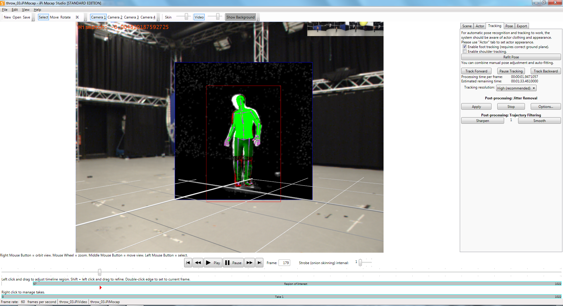

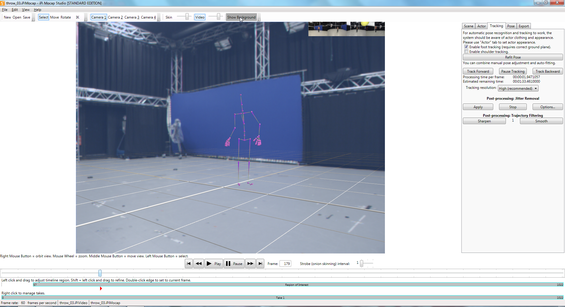

PostPosted: Tue Jul 03, 2012 8:05 am
Hi again
I've played a little with your video and have not got any of the issues you've mentioned.
Here are my screenshots for Show Background and Pose Mismatch.
File comment: Pose Mismatch in action
File comment: Show Background in action
