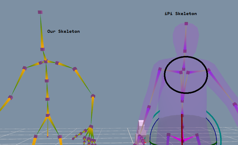

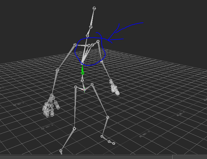

We are having a problem and we are hoping for help. Everything has worked up to the point of exporting the animation to a target character. We load our target character, and when we play the animation everything works fine. When we export the animation and open in it Motionbuilder our skeleton is not loaded instead, the iPi default skeleton is. Any idea as to why this is happening? I am attatching a couple of screenshots to illustrate the problem.
In iPi Studio
In MotionBuilder

We can recommend 2 ways to export from iPi in this case.
One is to export as a Motion Builder BVH and the other is to export just a BVH (as your target bones)
When you export just a BVH from iPi it uses the target character bones.
When you export as a Motion builder BVH it exports a rigg that iPi makes which is characterizable in Motionbuilder.
So if your exporting as a Motion Builder BVH it will export the iPi Skeleton and not yours,
if you export as just a BVH in the top option of export, it will export your target characters bones.
