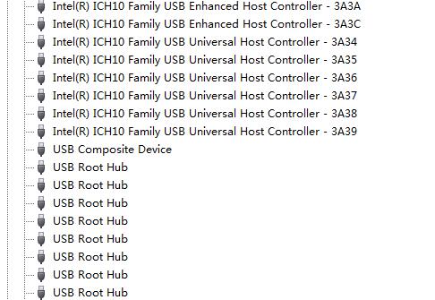

thanks,how can I know that how many USB controller in my computer,here is my computer snapshot ,

I saw wiki and knew only 2 USB 2.0 controller in my computer ,others are USB1.0.I'll try to buy PCI card ,thanks again.
