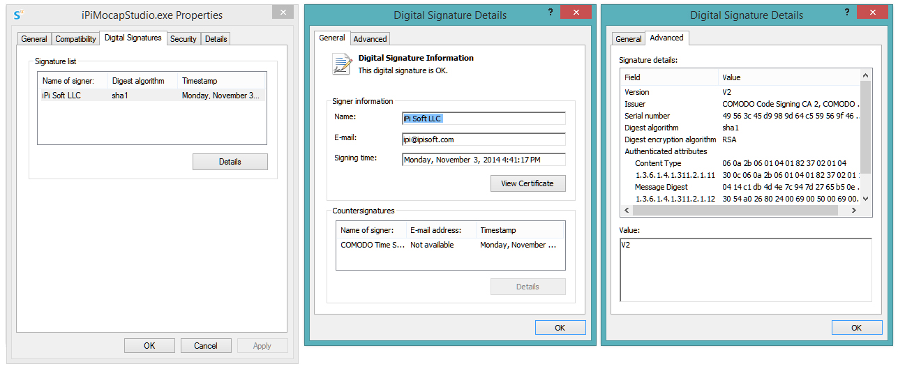

PostPosted: Wed Nov 05, 2014 8:39 am
Posts: 466
Thank you! It helps a lot. Can I ask you to screenshot properties of iPiMocapStuido application file ("Digital Signatures" tab):
  • In Windows File Explorer paste the following string
    Code:
    %ProgramFiles(x86)%\iPiSoft\iPi Mocap Studio 3
    to path line and press Enter
  • Right click on file iPiMocapStuido (with "S" icon and file type = "Application") and choose "Properties" menu item in the context menu
  • Switch to "Digital Signature" tab
  • Make screenshot
  • Share it with us
Thank you in advance and sorry for this inconvenience!

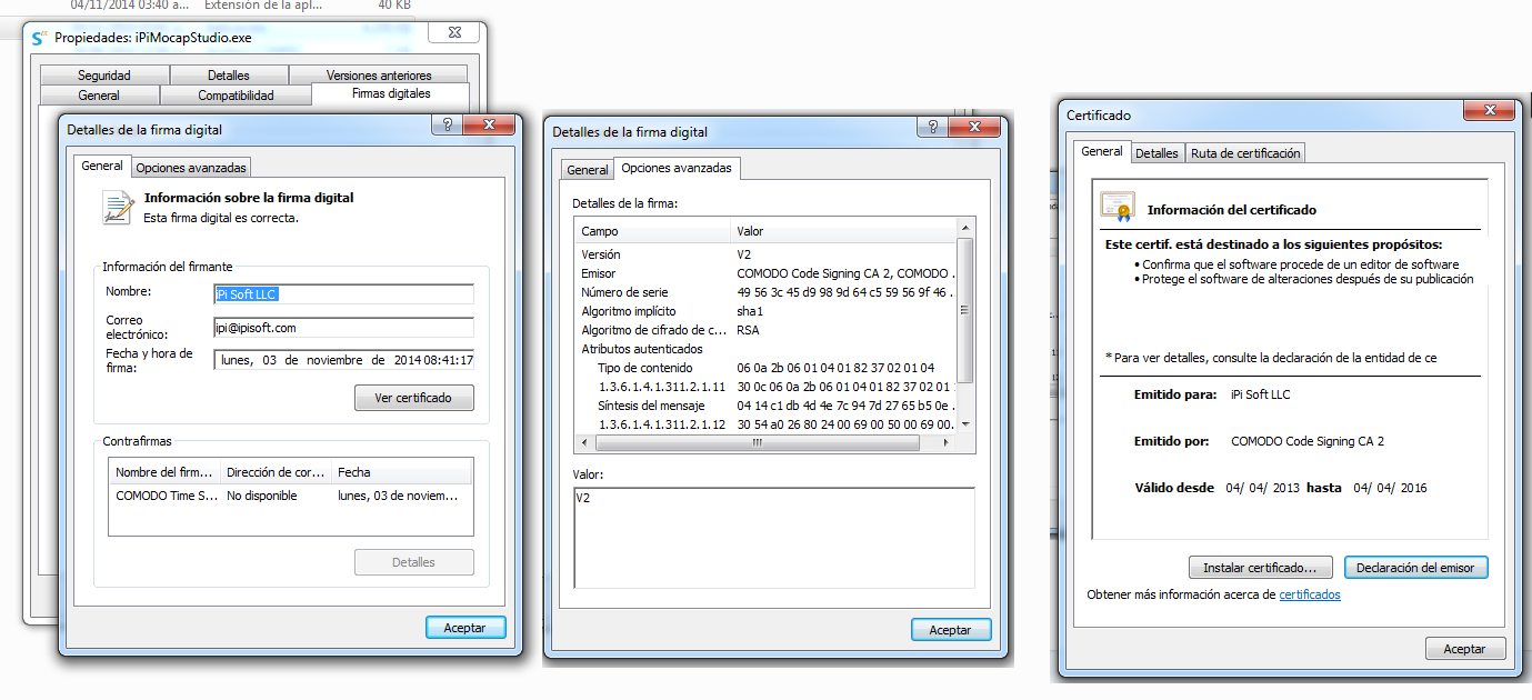

PostPosted: Wed Nov 05, 2014 9:39 am
Joined: Tue Nov 04, 2014 1:08 pm
Posts: 10
Sure, here it is
PostPosted: Wed Nov 05, 2014 11:03 am
Posts: 466
Thank you very much!
Looks fine. Mystery..
