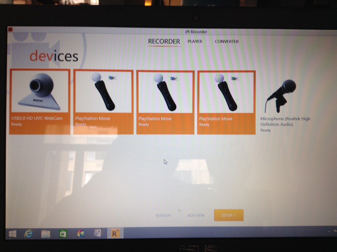

For whatever reason, I must have forgotten to PAIR the Move controllers in MotionJoy to this TrendNet Dongle. I was under the impression that once you paired the Move controllers once, that was it, but I learned that you must do the pairing while you're in MotionJoy with the new dongle.
Thank you so much for looking into this problem with me:)
See the attached screenshot from V2 to see that things are connected and "READY"
No errors. Haven't tried recording, but I will soon.
To others out there without Bluetooth, I recommend the TrendNet TBW-106UB dongle. It's not sexy, but it's cheap and it works just fine with 3 Move controllers.
Make sure you install the driver for your bluetooth dongle in MotionJoy and while you're there at the same time, pair your Move controllers with the USB. Once you do that, you should be good to go. I was going crazy trying to get this work for the last few days. Finally figured out what wasn't working.
File comment: WORKING!:D
