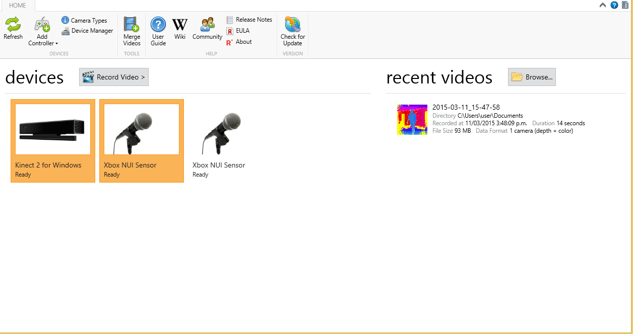

I am not able to read 2nd kinect 2 in ipi recorder 3
does any one know what might be the problem.
I am not even getting any error while plugging it in
If i connect it separately it works properly. but connected it with together it doesnt work.
I also have met all the specification which is mentioned on website .
Please check the attached image
Please help me its urgent.
Thanks.

As I've answered you by email:
Quote:
Microsoft Kinect 2 SDK supports only single device. And we cannot overcome this limitation on our end.
Thus, you need to connect each of the sensors to a separate PC and use the distributed recording feature.
Actually, this limitation is noted both on the web site and in docs:
http://ipisoft.com/software/basic-edition/ (see Additional Requirements section in Recording block)
http://docs.ipisoft.com/Depth_Sensors_Comparison

Hi, the ipi recorder I use doesn't show slave option on top .. Which version should I use ??

The latest, of course :)
Buttons related to distributed recording are located at the RECORD tab in case you've missed that.
