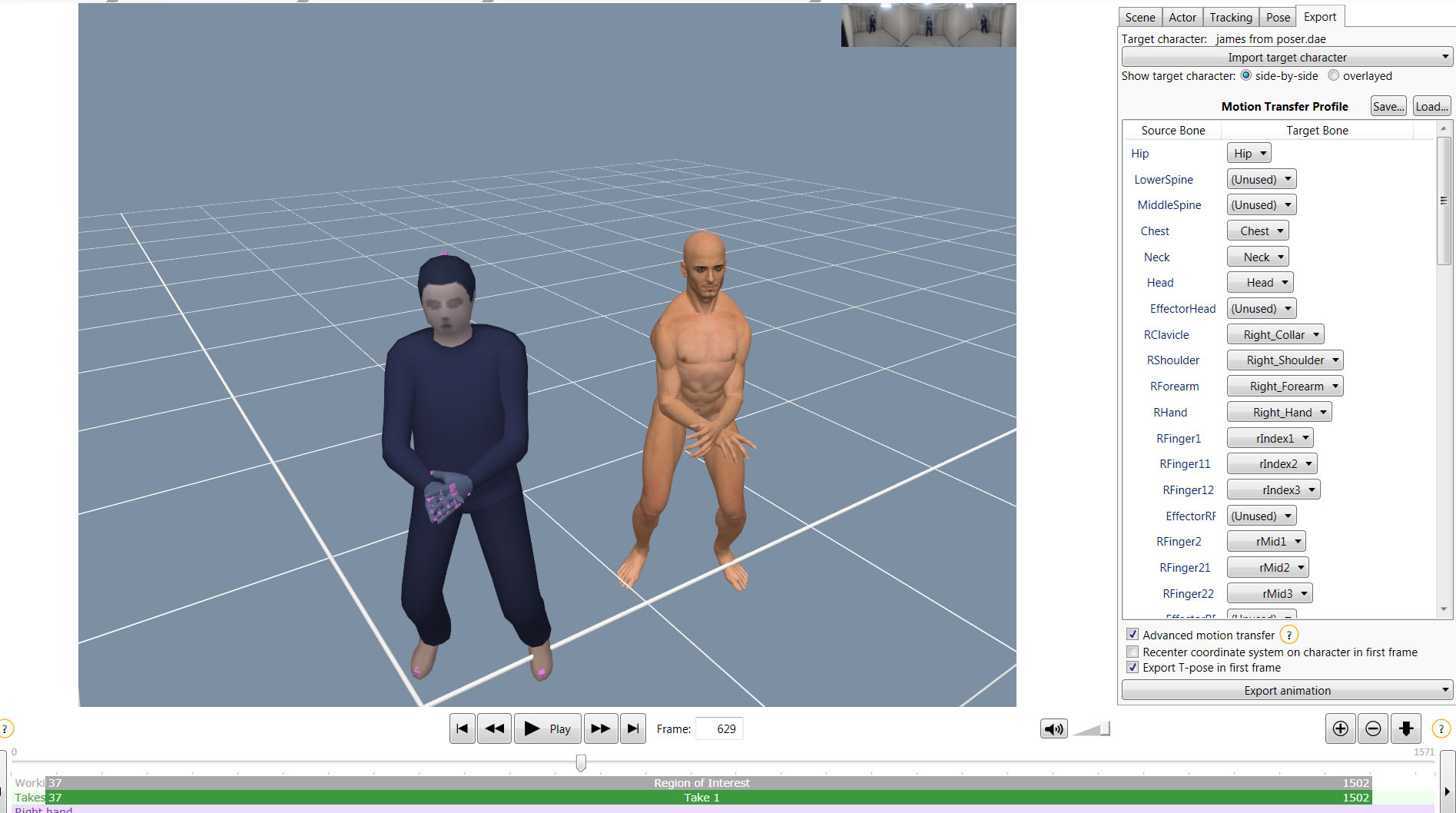

Transfered character from Poser to Mocap and this results that get:
1.James character

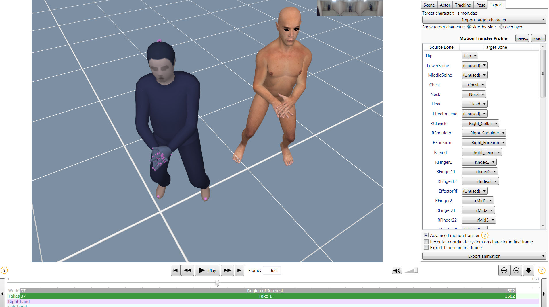

2.Ryan character
James give totally incorrect hands position. But Ryan also give not 100% correct pose.
The same result in BVH.
Where is my mistake? I don't tried another characters from other programms.

PostPosted: Mon Nov 25, 2013 12:33 am
Check the bone mapping at the Export tab. There may be some confusion between shoulder/clavicle bones of your character and model in Mocap Studio.
PostPosted: Mon Nov 25, 2013 1:46 am
Joined: Sat Nov 23, 2013 1:45 am
No, there is two characters from Poser with the same bones mapping (clavicle/shoulders is correct; I'm sure in it 99.99%--checked many times) that give different results.
