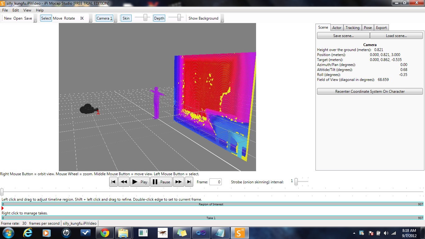

Hi, im having an issue, getting my recordings to appear in ipi studio 2.0 as 3d depth video.. I've tried using a single kinect, ive tried converting a previous video with an old version of ipi recorder and even downloaded sample depth videos from this forum, but every single video appear as flat 2D images or videos in ipi studio. Ive used ipi studio 1.3 and when i import my video in the application, it works perfect as a 3d depth video, but every since i switched over to ipi studio 2.0, all my videos appear as 2D instead of 3d. Can someone please help me resolve this problem?

Hi, thanks for responding. I have tried the things you have suggested, but nothing has worked. Here is a pic of my error, so that you can get a better look at what im talking about.

PostPosted: Fri Sep 07, 2012 7:00 am
Yes, it looks very wierd :(
What version of Studio do you use?
What is your graphics card model?

Im using ipi studio v2.0.1.138. My graphics card is an "Intel HD Graphics" card, driver version 8.15.10.2622. Lol it sucks having an integrated graphics card, and not being able to change it, but im hoping my graphics card is enough to use ipi studio v2.

It seems your graphics chip lacks some capabilities to properly render depth point cloud. Unfortunately, the Studio could not determine this compatibility issue at startup, otherwise it just would not launch. We will try to update the checks to correctly diagnose this case.
Integrated Intel graphics is not compatible with our software with rare exceptions. Anyway, it has very poor performance for the tracking process. It is highly recommended to use at least mid-range discrete video card.
Did you use v1.3 with this same graphics chip?

Yes I have used the same graphics chip for 1.3 and it worked fine. I guess if i cant use v2 then i will have to stick with v1.3. Is there a huge difference between ipi studio v1.3 and 2.0?
