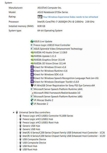

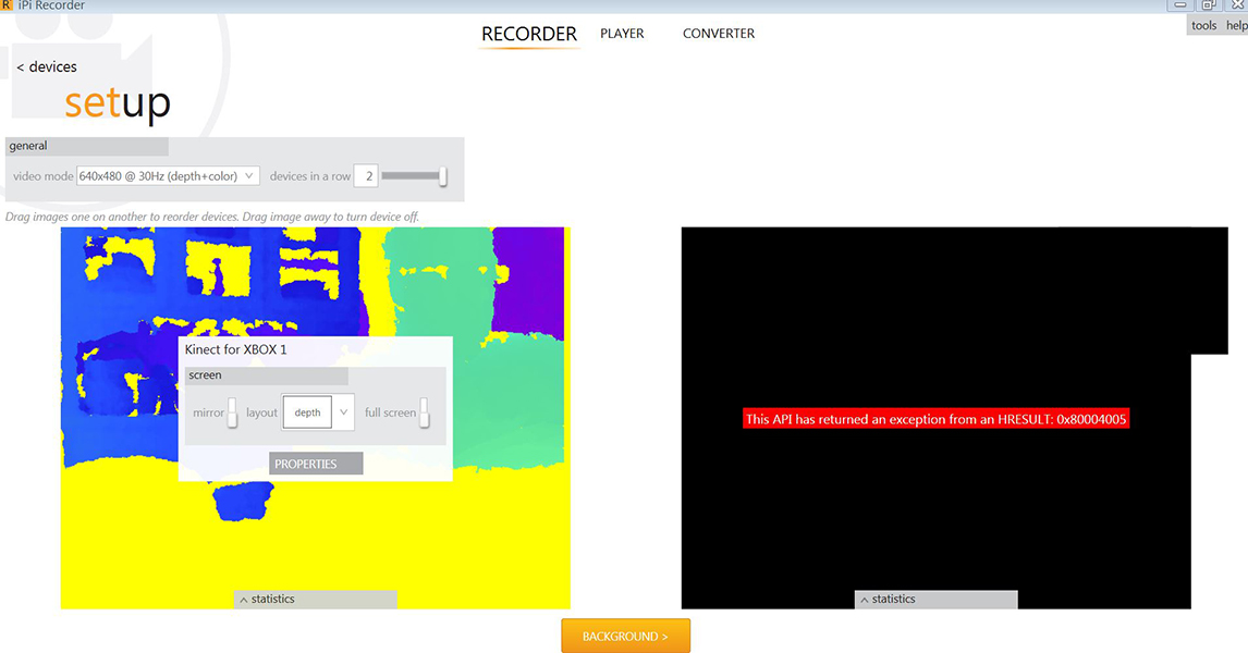

I have two kinects, one plugged into a USB2 and it works fine. The other I have plugged into a USB3 and it flashes this warning.
"this api has returned an exception from an hresult 0x800040005"
Not sure how to fix it so I can use two kinects. I tried switching the kinects, I just get the same error on whichever Kinect is plugged into the usb3. I tried updating the drivers to the usb3 but it didn't help.
Can someone please tell me how to fix so that I can use two kinects?

Hello
We already have a couple of reports about compatibility issues between Kinect and FrescoLogic USB3 controllers:
http://forum.ipisoft.com/viewtopic.php?f=5&t=6355
http://forum.ipisoft.com/viewtopic.php?f=5&t=6791
Please try using PrimeSense drivers for Kinect as it is suggested at the bottom of the last topic.
BTW, what model of Kinect do you have - for Windows, or for XBOX?
