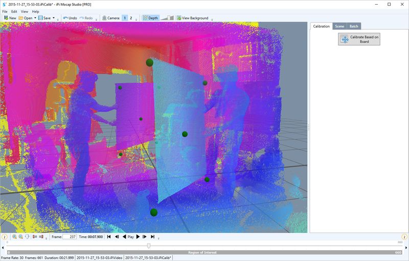

I did run into one problem which put a stop to my session this afternoon. This was mentioned earlier (perhaps in this thread by Snapz?) but Mocap Studio seems to get confused about the location of the sensors and places them both in the same position. To illustrate, here's a screen cap of the calibration result:
I remember seeing this error a long time ago with multi-Kinect (v1) so it was surprising to see it return with multi-KinectOne (v2).
